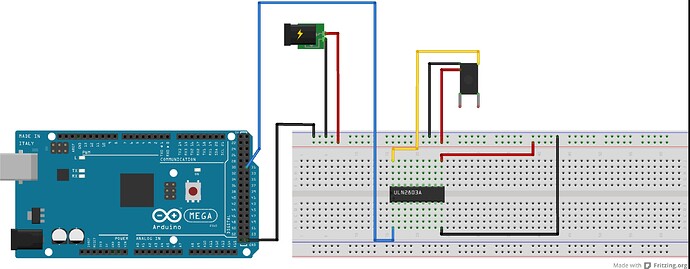

2x Arduino: One as a power supply, One actioning 4 relays
If you only have 4 realys to drive on the Adruino, don't use the 2803.
jumper JD-Vcc to VCC, Arduino +5 to relay VCC, arduino GND to relay GND, Arduino o/p pin to IN1 and IN2.

In this stage a have only 4 relays. The finished project will have at least 10 relays...
LarryD:
That's how i used it so far...
But when i turn them on, i don't have 5V on Ardiono +5V pin anymore...
That's why i want to supply power for them from an external power supply (EPS).
So it will go something like this: connect the relay's VCC to the EPS +5V, the relay's GND to the EPS GND, and the INT1 and INT2 to the Arduino digital pins...
Connect the 2803 o/p to IN1 or IN2 then External +5V (not the Arduino +5) to Relay VCC/JD-VCC.
In this case a HIGH on the o/p of the Adruino will close the contacts.
Of course Arduino GND to relay GND to external supply GND.
With 10 relays use the 2803.

After i saw your message, this is what i understand (keep in mind that i'm from Europe :smiley: ):
  • Connect 2803 o/p to IN1
  • Connect EPS +5V to Relay VCC
  • Connect ALL the GND line together
    -> And what about the Arduino pin? Where to put that?
See the schematic:
Arduino O/P Pin 31 to 2803 pin 1
2803 pin 18 to relay IN1 or IN2
Relay JD-VCC to relay VCC to EPS +5V to 2803 pin 10.
Relay GND to Arduino GND to 2803 pin 9.
Note: in your last schematic you should have 2803 pin 9 to GND
Yes, sure. I was hurrying...
Ok. So, like in the attachment right?
I did this same thing in the first schematic. But i didn't know if it will work. :smiley:
I'll give it a try when the 2803s arrive... :smiley:
Good for you, you have got it!
