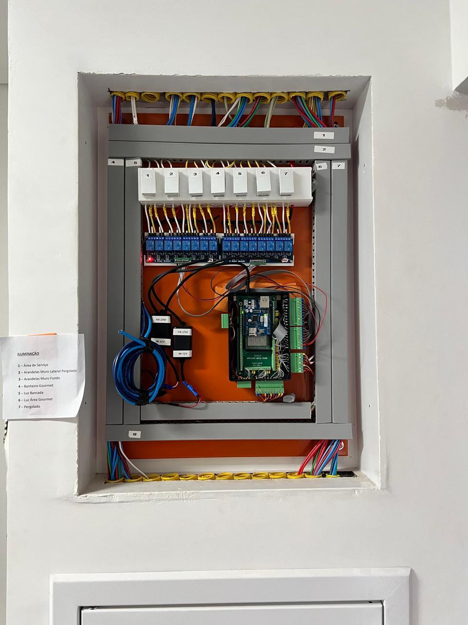

I'm using Arduino Mega with two Arduino relay module with 8 channels. This project is used to automate the lamps of my house (Leds), and I have two strip led lights too.
Some time when i press a button to turn on a lamp/led, the relay doen't trigger to light the lamp.
I powered each relay module with a dedicate power supply (5v).
It looks my Arduino Mega 2560 can't support all 16 relays, is it true? How do I check it?
Has anyone ever done something similar?

Here is the picture of my project.
I think I see ground wires between Mega and relay boards.
That defeats opto isolation.
There should be NO ground between Mega and relay board, just VCC and the inputs.

Did you use snubber circuits on the relay contacts. Those relays will eventually fail (closed) and the software could hang if you don't use snubbers.

I'm using snubbers on every lamp/Led
