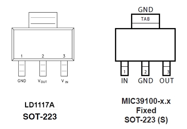

I think i will stay at linear voltage regulator, you know the transistors with few caps will do the job for my
circuit. Found L7805CV, LM2940 for 5v and LM1117 for 3.3v, do you know any other for 3.3v ?

Going from 5volt to 3.3volt is only 1.7volt difference.
Much easier for a lineair regulator.
Standard 1117 regulators top at 800mA.
If you want more current, it might be wise to look at the Pololu website for a 3.3volt buck regulator.
LM232 - 3A
MC33269
LD1117#33
LD2980ABM33TR
LD2980ABU33TR
LD2980CM33TR
LD1085#33
LM2931AD33R
