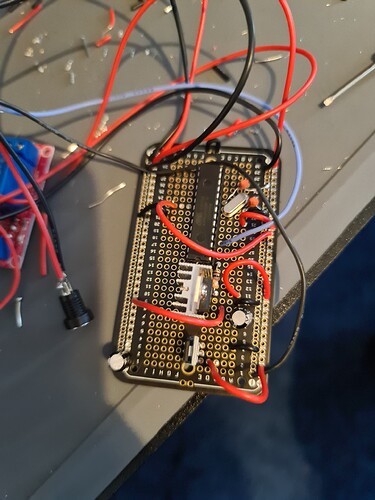

Hi everyone, I was hoping someone could shed some light on an issue of mine. So I have a 3.3v regulator which steps down the voltage anywhere from 12v to 5v. I tested the chip on a solderless breadboard by its self and worked great (checked voltage with DMM). However when I soldered it onto my full project, it doesnt output 3.3v, when supplied with 12v it outputs around 6v, and if supplied with 5v it outputs 2.5v ish. Does anyone have any idea as to why this is?
The schematic is attached below.
Thanks in advance.
Dean.

What voltage do you measure between your PCB gnd and the gnd pin of the regulator board.
It sounds like you have no gnd connection to the gnd pin of the regulator.
Can you please post a picture of your project so we can see your component layout?
I have two voltage rails one 12v and one 5v. They both read what they are suppose to.
Here are the photos
Where is the 3.3V regulator that you linked to?

Where are the bypass capacitors that linear regulators like yours require?
I suspect no ground reference between the regulator input and output.
I've never had one fail me. I've used about a dozen on various projects.
From your schematic, it appears that you are powering the 3V3 regulator from the 5V regulator with no bypass capacitors? Did this combination work on the breadboard?

Thanks everyone for your help, but I just realised that my bluetooth module works on 5v where i thought it ran on 3.3v TTL logic, so I am going to just use 5v. Thanks so much for everyones help, i should have checked this sooner I just thought 3.3v was correct from memory.
