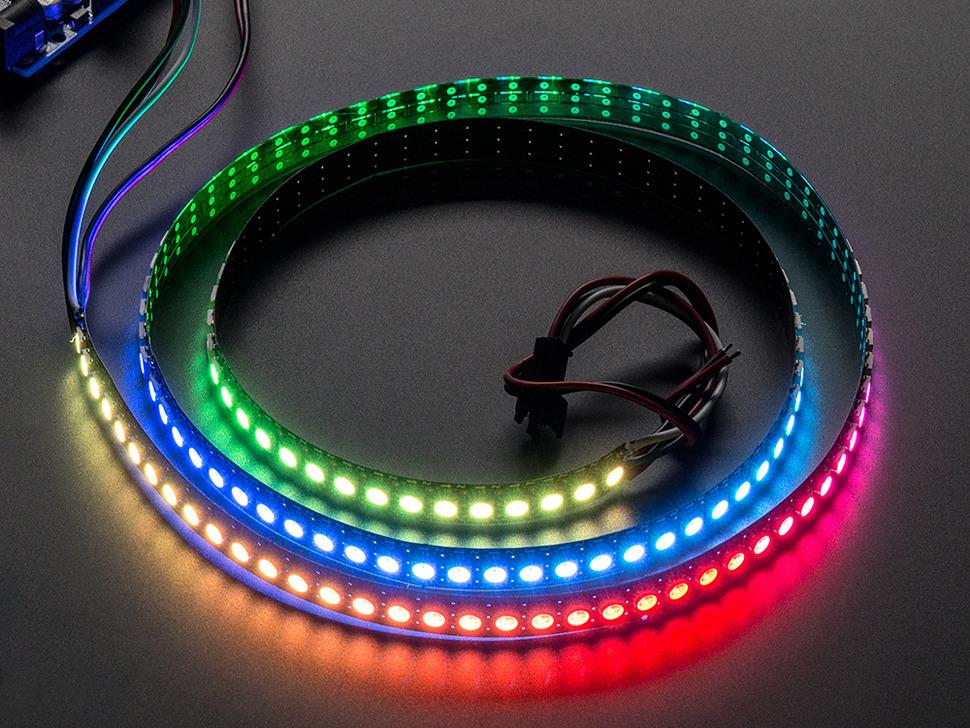

Have you considered using a NeoPixel strip ?
IMG_2068
You could have as many LEDs as needed, any colour, all on a strip of LEDs.
Only one Arduino pin is needed.

Wait one second, these strips can be cut into 1 led?
Yes you can cut the Neopixel WS2812B strips between LEDs, 1, 2, 3, 4 etc.
Also, these are available, 100 for about $20.00 on Amazon.
