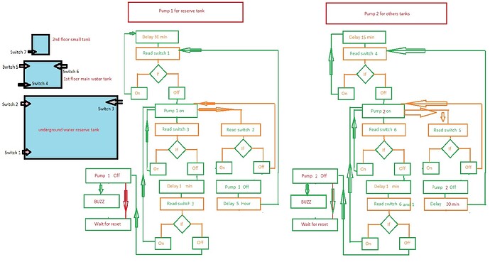

I'm trying to makes auto water pump controller. I'm found lots of code in google, but the problem is, in my house we have 3 water tanks! and 2 pump. 1.5hp submersible pump only fill the underground reserve tank. And another 1hp pump pulling water from reserve tank to overhead tanks. And there is two water tanks in different size and height. I didn't find any code in google for this type of scenario.
Now here is the big problem, i'm very new with programing. Then why not i'm buying auto devise.
  1. Because its not available here. 2. It will be fun to makes myself 3. It's helps me to understand the arduino code.
I'm going to use float switch to sense the water level. I got some similar at
incomplete and not for me also.
So i'm seeking help from here.

I have not done yet programing c++. So its difficult to me to makes a flow chart and then write the code. So i'm looking help here. Its for my home.
My connection diagram i have showed in attached file roughly. I have found some water pump controller using float switch. But i cant edit for my case.

Without 100% confirmation, I'm not going to connect anything with my motors. This time i'm just looking for arduino Program. I have made a flowchart. Maybe this can be helps. Ignore the relay, connection, motors and others stuff.
Image from Reply #13 so we don't have to download it. See this Image Guide
...R
Sorry. I can't read that image even if I enlarge it.
...R
