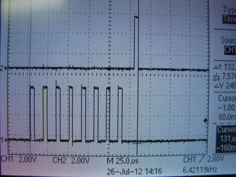

I read 132 us to put a character on an LCD using a 74HC164 shift register.
I use shiftout,clock on D3,data&RS on D4 and enable on D2.
I don't consider this slow. The attached scope photo has the enable on the top and the 8 clock pulses below.

I didn't see anything about LCDs there. Did I miss it? Is that link to the details correct?
In terms of "slow", it depends on your view of what "slow" is. Every thing is relative.
To me, 132 us is VERY slow compared what an AVR at 16mhz is capable of doing.
It is the Arduino core code that is so slow. shiftout() calls digitalWrite() to set the pins
and the digitalWrite() code implementation in the core code is quite slow compared to what can
be done even when the Arduino pins are configurable and not constants.
(if using constants the clock on the SR could be strobed every 125ns)
shiftOut() itself is not very optimized code. It runtime checks on shift direction and doesn't
do its loops as well as it could (should).
Just re-rewriting shiftout(), even when still using the slow Arduino core code digitalWrite()
functions can speed things up.
The shiftout code used in fm's library (which does not use any Arduino core code) can shift out a byte
and strobe a separate E/Strobe line in under 16us. - see the attached analyzer shot.
It reduces to a couple of microseconds on the Chipkit Uno32.
It is isn't clear what is represented by the 132us analyzer shot.
I can't tell if it is the full amount of time to put a character on the display
or just the time it takes to shift out a byte, set up RS and strobe E.
i.e. can you sustain that time/rate for back to back character writes?
In order to measure that time, it is best to measure between two back to back character writes.
I say "character writes" because there is more timing overhead than just the shift operation and the E strobe to the LCD.
There is also LCD timing overhead that must be honored to ensure that the lcd is given enough time to process the
operation before another operation can be done to the lcd.
The best time measurement is the time between to back to back lcd.write() calls.
This measures all the overhead as seen by the sketch. It includes all overheads including
any s/w overhead in the library as well as the the time to get the data to the lcd.
It is a true measurement of how long it takes to write something on the lcd.

bperrybap - Thanks for your comprehensive and knowledgeable reply concerning LCD writing times.
I will try to fill in the blanks a well I can.
  1. The link is OK - the button linking to my first, and only, Arduino project is at the very bottom, since they are in chronological order.
    However I have attached a screen shot showing an inter-character interval of 188 us, plus the class I wrote and the shield circuit diagram I made.
  2. "fast' does depend on your expectations and experiences. I have been using Picaxe with the same circuit and it takes milliseconds, it even requires bit-banging!
  3. It is a HD44780 character display, so great speed is not needed - there are only 40 characters and the user must read it.
  4. You are supposed to monitor the HD44780 busy flag and then wait another 4us. Time after write to end of busy is listed as 37 us.
    I didn't bother, just put in a 45us delay.
