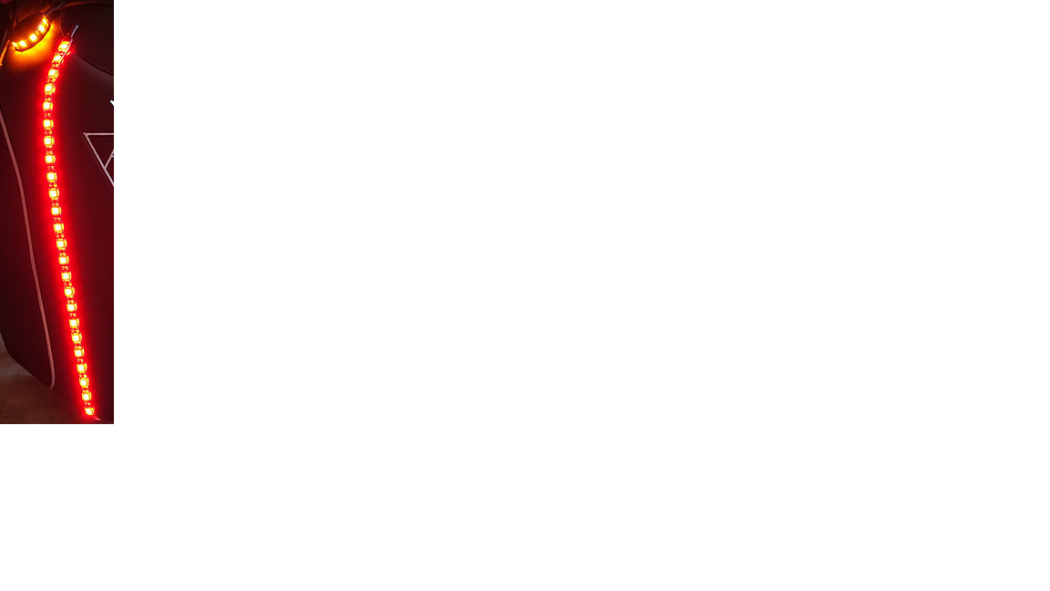

Hi All,
I am starting to do a project with the pro mini where i need to drive this scenario.
2 strips led , those lengths , any guidance on how to achieve this , the I/o is 40ma max
2 x each strip will draw about 500ma as i calculated max and running about 1/2 that.
i would want to run this on like a lipo 3.7V ~15,000 mha. :slight_smile:
The Arduino’s output pin does not supply the current only a data signal so that circuit is nearly right. Put a 470R resistor in seriese with each data signal and a 470uF capacitor across the power pins of each strip.

That is an RGB strip? Do you mean non addressable strip? If st that would be totally different and you would need FETs to turn on each colour but you couldn't drive it very well from just a 3.7V battery.

in the pic i sent i did
48 led * 10ma at (parking light style) and 20ma when (brake style lighting)
480ma draw vs 960ma when needed here and there.
am i right to assume that the battery would last 15000mah/960ma =~15 hours or 31 hrs constant before depletion if that is all i am running (without arduino ofcourse)
would you know an efficient way to have 48x20ma neopixel draw minimal power
Just send smaller numbers to it. A brightness value of about 8 is very bright if you are looking directly at it.
In theory that is the maximum you would get. In practice batteries don't often live up to their billing. The manufacturers set the discharge rate to some secret value that makes the end mAh as big as possible. They do lots of tests to find the best discharge rate.
