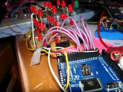

I've finally completed a project that I started some time back.
As the title hints, it is a 3X3X3 LED cube. Using 27 LEDs, it creates
some cool patterns and effects. I used two codes for this project.
The first one was boring, so I re-wrote it to be much more exciting.
Now, it is 8 pages long (size 11 on word), 359 lines long, and 6246
characters. This means that I will have to keep the description
brief to fit in everything.
The code is here:

I wrote all of the second code in a night or two. The hardware took a couple
of nights to complete, but I ended up doing several projects in between
building the hardware and writing the new software, so it was a month
or two between starting and finnishing.
Here is a video to show everything:
The cube uses 5 functions, all written in the software, then randomly selects one
to create lots of interesting effects. As it is only a small cube, it uses no
multiplexers and can be controlled from the duemillanove, uno, or something
similar. Now, I wonder why I used the mega instead. Ah well...
Hope you like it!
Onions.

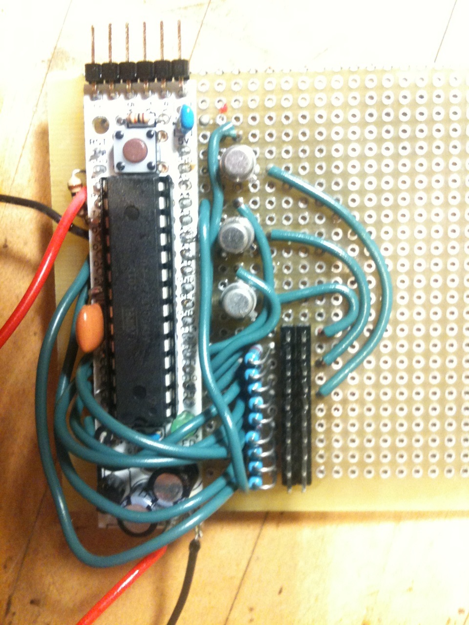

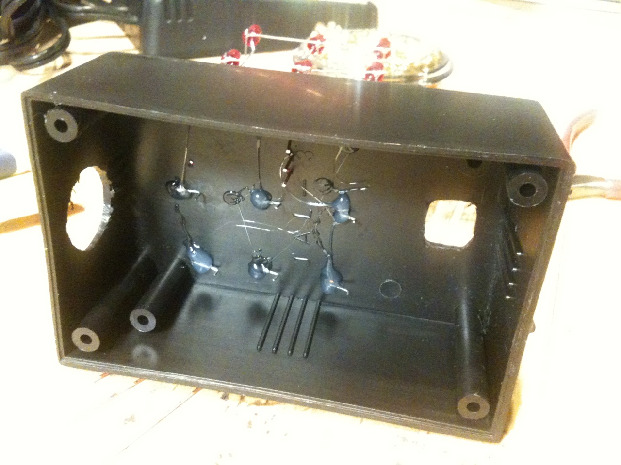

Nice! I've been working on mine for a while now. Putting it into a project box. I laid out the circuit on a protoboard but when I apply power nothing happens. I have a short somewhere. Need to find it.
I'll share when it's done and working.
You're better than me! Mine will get no fancier than it is now (hardware wise) - all the solder joints and wires will stay on show.
You could put it in a clear acrylic box so it is protected yet still all visible.
Maybe find an old snowglobe & reuse it?
That sounds like a good idea! Maybe I will do it after all...

Well overall it will look OK but my cube is kind of funky shaped. Figured putting it in a nice enclosure would make it look better. :stuck_out_tongue:
It's real close. Just needs an hour or 2 more work and I'll be done. Then I'll post up my own thread and stop hijacking yours. :stuck_out_tongue:
And it does, it's looking very good!
Was that the RBBB I noticed in the bottom picture? It is something I need to treat myself to some time.
:smiley:
RBBB - what do you normally use instead?
Yes, I bought 2 RBBBs un-assembled, one for this project and one or the next one I'll be working on. Then I figured I'd have enough practice to try one on my own. I made a ton of mistakes on this board but overall I'm happy with it.
I was going to mention and forgot to, I picked up a 20 pin ribbon cable which I'll be soldering directly to the leads on the bottom of the box. That will then connect to the header pins on the board.
Oh, and the holes for power (round) and pattern (square) are rough but the buttons cover them up and hide the rough edges. The 'pattern' button will cycle through the 8 or 10 patterns I have programmed in.
That's a brilliant idea!
I just used a piece of stripboard (in the photo) and made it up as I want along. By not using a plan, it had the disadvantage that I could not tell if something was connected onto a strip or not. I think this probably has something to do with the transistors not working.
