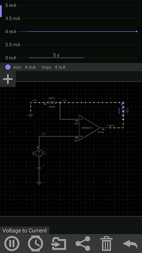

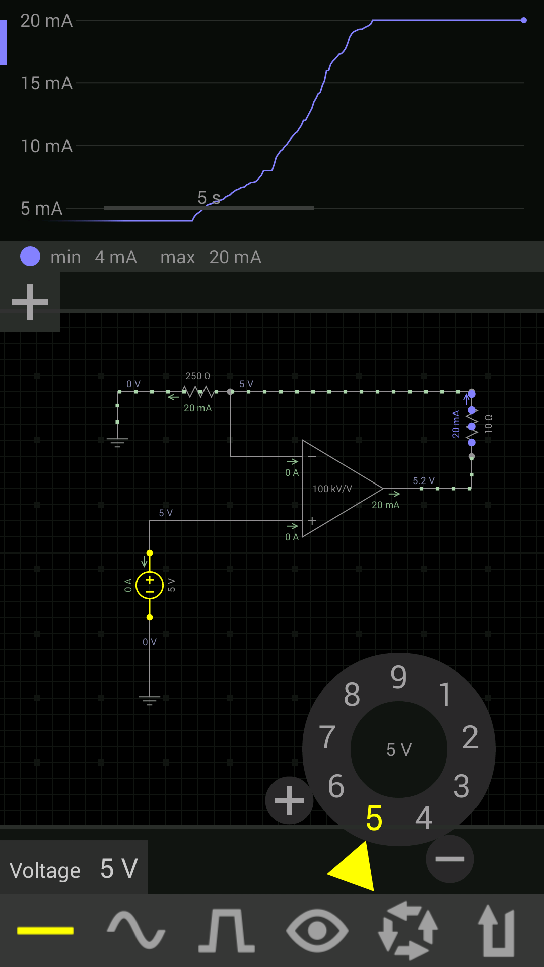

I have done a lot of Googling since and am leaning towards a simple op-amp/transistor setup. Like the diagram below, but using an analogue pin and smoothing cap instead of the zenner to provide the input voltage.
I will prototype it in the coming days and will make up my mind then.
