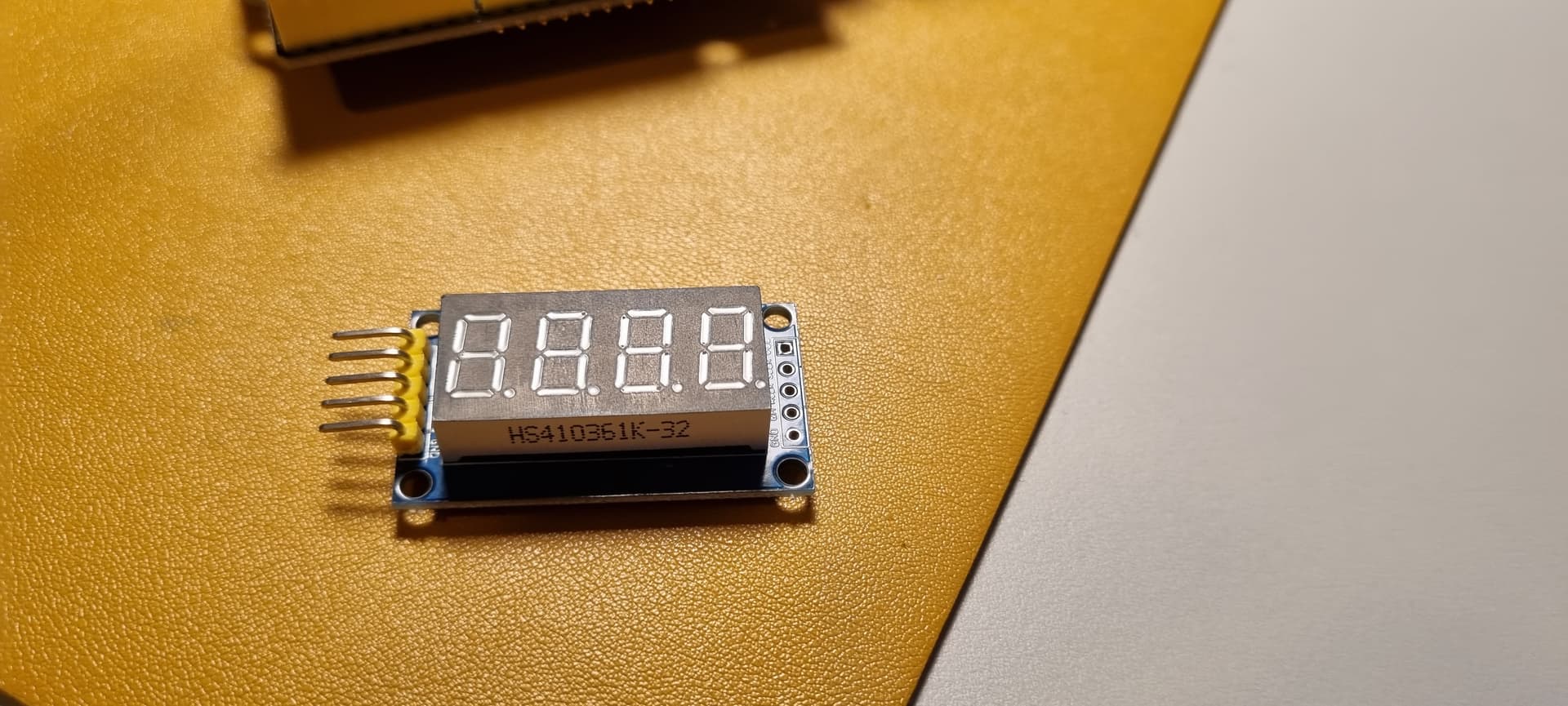

Hi Forum,
Can someone guide me to some working example for such a 4 Bit Led Digital Module?
It's a HS410361k with 2 74HC595 IC on the back.
I tried several tutorials like Arduino 4-Digit 7 Segment Display 74HC595 module - Ardumotive Arduino Greek Playground, but I just can't get it running.
Very confused with the QH, ACLK and SCLK signals, tried in all combination with the standard SDI, CLK, LOAD without much success.
Thank you in advance!

You showed us the markings on the cascade output side. Those connections are for daisy chaining multiple modules.
What are the input markings?
You mean these one?
It's the same as on the other side:
VCC, SCLK, RCLK, DIO, GND
