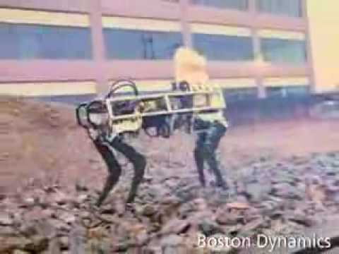

But you know that a 4-legged walker is not stable in steady-state while not moving and keeping one leg up?
As soon as a 4-legged walker pulls up one leg, it is behaving like a 3-legged chair.
A 3-legged chair keeps standing, if the center of gravity is located above the contact area.
So if you think about a 4-legged robot, who pulls up one leg, what is happening?
Let's think about this one, the center of gravity marked '+C'.
|  +C     |
In a non perfect world, the center of gravity will not be perfectly fitted, but moved something to the left or right, or top or down.
So if the robot lifts one leg, you get either a triangle of contact area where the center of gravity is within the triangle. In that case, the robot will stay standing.
Or you get a triangle of contact area where the center of gravity is outside the triangle. In that case, the robot starts falling to the side as soon as you lift up the leg.
So with a 4-leg robot, typically the chance is 50% against 50% that you can lift one leg and the robots keeps standing. If you lift the wrong out of the 4 legs, the robot starts falling to the side immediately if you lift up one leg. And sooner or later you have to move each leg while walking.
So walking may become a problem if you are unable to create and solve differential equations of higher degrees in real time to create solutions for a smooth real time balancing with dynamically moving four legs.
Here you can see a 4-legged robot walking:
I think the project needed a lot of engineers for several years to make the robot move such as you can see in the Youtube video.
Balancing a 4-legged robot is much(!) more complicated than balancing a 6-legged robot. A 6-legged walker can always be constructed with his 6 legs and the center of gravity, that up to 3 legs can be lifted up at the same time without falling to the side. But with a 4-legged robot you cannot even select each single leg out of 4 for lifting without falling the robot to the side. So a 4-legged robot always needs dynamic balancing.

But don't the two oppossing legs moving in sequence solve this? The front left and rear right leg would move in the same direction at the same time, leaving the front right and rear left legs as stabilizers? So two legs always making contact with the primary weight always pulling down and towards the middle?
Thanks for the great explanation, would the above solution solve?
joshuaembry:
try it. make a box with 2 legs on opposite corners and balance it
then see if it is possible to ballane a box on 3 legs
I have seen a wire-frame animation of 2-legged (human) walking and the process clearly involves a forward shift of the centre of gravity followed by movement of the legs to prevent you from falling.
I guess 4-legged walking is a little less complex, but probably not by much. Most animals can lift any two legs off the ground. And 3-legged dogs that have had a leg amputated seem to get by very well.
4-legged animals can eaily walk along the side of a slope - sheep don't really have shorter legs on the left side.

The point made - and in those videos - is that it is dynamic stability - requiring the ability to quickly move a leg into the correct position to compensate for "falling" and actually (not necessarily immediately) bring the CG within the stance.
