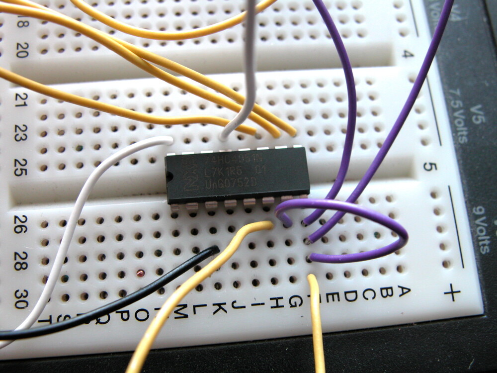

Yes, I am trying to read 8 potentiometers for a midi sequencer project.
For the moment, I have the circuit built with just one of the inputs hooked up to a pot.
Here is a photo of the wiring:
The black wire goes to analog pin 4.
One of the purple wires brings ground to the chip, from the arduino. The other purple wire that heads into the northern part of the photo is for ground to the potentiometer that I have hooked up to y0.
The yellow wires that you see at the bottom are actually just one wire, which connects those two pins of the chip together (ground).
The white wires are input (in the center) and 5v in from the arduino (on the left).
Is this correct?
You must connect the enable pin (6) to ground
At the bottom of the picture, you can see two ends of one yellow wire. They connect pins 8 and 6 together.
Wouldn't that work?
Is the pot hokked up as a voltage divider, like:
5V to one side pin, center pin to y0 on 4051 and other side pin to ground ?
Do you get any readings at all from the analogRead() ?
that should be ok pins 6,7, and 8 should be grounded AND connectd to ARduinos ground
Yes, the pot is configured that way. I do get a reading, but it does not seem relevant at all to the input I have selected.
What I mean is, I want to read just input one, and I can't figure out if it's doing that or not.

does the blink rate change if you torn the potentiometer ?
The analogRead should return a number in the 0 - 1023 range 0 when the pot is all to one side and 1023 when it's all to the other side.
