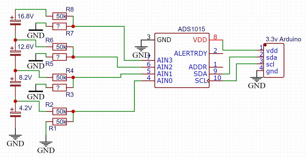

Hey guys total noob here. I have this 4S li ion battery, i would like to monitor each cell with my arduino. I dont have enough available analog input pins on board so im planning to use ADS1015 to measure each cell and pull the data with I2C interface.
Where im struggling to solve is how to connect each cell to ADS1015.
Currently i have a balance plug connected to the pack so i can get 4.2v-8.2-12.6-16.8v respectively relative to the packs negative.
I cant connect them directly because my logic is 3.3V so i have to use voltage divider for each cell. First cell is ok i can just connect it by dividing the value by 2 with resistors and multiply it by 2 on the arduino side.
for the second cell im getting confused.
can i connect 2.cell's voltage divider reference to 1.cell's positive side so i can still make the calculation from 4.2v and use the same resistor values all across for every cell? In this case on each hop i wont get more than 4.2v per cell and my formula on arduino side will be the same for each cell
OR
i should use common ground and adjust each cell's voltage divider circuit in a way that they wont exceed 3.3v and use the resistor values in arduino side for calculation for each cell. also in order to find cell 4 voltage i will have to measure and sum all 3 beneath it and subtract them from the 4th cell in order to find the value.
Im not sure which one is acceptable or even if they would work correctly. i attached both schematics for both cases in order explain it better.
Circuit 5 won’t work as the voltages at the higher cells will exceed your 3.3v . ( put some resistors together and try it ) . In option 6 you may not get the voltage resolution you want for the top cells.

i came up with a circuit 5 because when i check individual cell voltages from the balance port i put the negative lead of the multimeter to the positive side of the previous battery and positive lead to the positive side of the actual battery that im reading so thats why i tied the ground side of the voltage divider to the previous cells positive side but never tried it probably i should test it on the breadboard and see what kind of results im going to read.
The thing is ive got a charger/balance board and it does the job but occasionally i would like to read the voltages and see their values. currently im removing balance port and checking each pin with a multimeter. circuit must be as slim and small as possible. this chip looks like a good option but only if i can make it work :slight_smile:
if the circuit 6 wont give me around 10-20mV resolution then theres no point in it.

im gonna try the schematic 5 for the first 3 cells on the breadboard using resistors and see what kind of voltage im going to get and report it here.
so halfway thru when i was preparing the breadboard i realized although im changing the reference of the voltage divider im not changing the reference of ADS1015 so it wont work tested it and voltage goes up in 2V increments. for 3S final value became 6V.
so the only option im left with is the diagram no.6 i think it should work at least for some reading.

im aiming for 10mV resolution i found some %0.1 resistors and for example if i want to measure fully charged 10s battery thats 42V!
if i feed it through 255K- 20K divider i will get 3.055V reading which is in good limits of my logic.
lets say battery dropped 10mv and the actual voltage became 41.990V then i will get 3.054V which is for 1mV drop in my logic i get 10mV drop in the battery.
according to the https://github.com/adafruit/Adafruit_ADS1X15/blob/master/examples/singleended/singleended.pde
ads.setGain(GAIN_TWOTHIRDS); // 2/3x gain +/- 6.144V 1 bit = 3mV 0.1875mV (default) for ads 1115 each bit is 0.1875mV which way less than the 1mV value i need. thus it can compensate for the fluctuations if there are any.
im not sure if im looking at this correctly im just trying to make sense but it looks like it could work :slight_smile:

Not sure where to start correcting.
Did you Google things like "battery stack cell measurement site:arduino.cc"
The ADS1115 on a 3.3volt supply is best used at PGA2 (2.048volt).
So calculate your four dividers for that to get the full 15-bit (not 16) resolution.
0.1% resistors is throwing away money for nothing.
Just use common/stable 1% metalfilm. You must calibrate final readout anyway.
Measuring a 3S or 4S pack with four dividers might be just OK, but a 10S pack...
Dividers discharge the pack unevenly.
The lowest cell needs to support all dividers, the top cell just one.
A "flying cap" circuit might be more suited for a 10S pack.

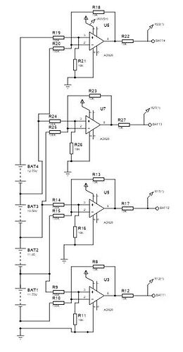

I was working on something like this for 4 6V batteries , It works in my simulator but not tried it in the real world, I'm yet to build it and test it, The Bat1-4 just go into the ADS115
Would something like this work ?
Steveiboy:
Sure. Something like that has been done before.
Leo..

i saw that PGA2 option so its definitely worth to recalculate my resistor values to benefit from the full range. each cell is 9Ah do you think drain will be significant to unbalance the pack considering i charge it every 2-3 days sometimes once a week
Drain depends on resistor values, so you can calculate that.
If unbalance is going to be a problem depends if your pack has a cell balancer.
For a 4S pack (16.8volt), resistor ratio should be 1:7.4 if you use PCA2.
Can use the same dividers for all taps, to keep resolution the same.

ok i will recalculate the resistors according to PCA2 i will take 1.95V as my max to have some head room and test the whole thing. probably leave it for 2 weeks and see the result but even after that BMS should take care of the drift.
10k:75k could work (1.9765volt, 3.6% headroom, 4.35volt/cell).
75k is a standard E24 value, but can also be made with 2*150k in parallel.

Not if you keep divider values the same. The stack/cell voltage resolution will stay the same.
Not wise to lower resistor values for lower cells, because of skewed cell discharge.

i was planning to use fixed R1 value for each cell and change only R2 according to the cell number to keep the resolution at max.

after a long wait i got the ads 1115 boards and tried to measure 4s pack which was very successful and i liked how calm the readings were, they werent jumping around etc but calibration was needed so i just corrected the multipliers in the code until i get the matching values for each cell to the readings in my multimeter.
i was thinking about the uneven discharge you mentioned. what if it cut the pack ground from the common ground and put it behind a mosfet, in a way that it will only activate when theres a power in the I2C(ads1115) device? would this help at all?
ok that above post wont work im not very familiar but i guess i need to use mosfets for each cells low side in order for it to work. instead may be if i can drain batteries equally would be better and simpler for me. my initial test and thinking was to have a constant R1 for each battery and calculate R2 which yields in different drain values on each cell.. circuit1
instead if i adjust the R1 along with R2 i can get around the same drain on each cell according to this simulation. does this looks right? circuit2 around 13-15 microamps drain for each cell
