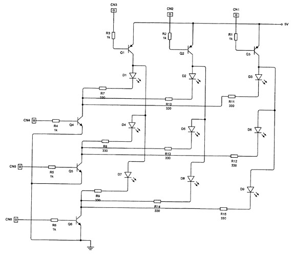

@ conmor2125
Since you don't have a schematic to show us. To design a code for a multiplex matrix system, you have to turn on/off the col / row. In my schematic.. ( a reversed engineered Matrix ) a one cell is show. I call X axis and Y axis ( I got confuse with row / col ) To turn the LED red Q1 is turn on by a LOW, and Q2 is turn on by a HIGH. and Q3 is off by a LOW. So the code will be :
digitalWrite ( pinX, HIGH );
digitalWrite ( pinY, LOW );
delay ( 500 );
So use a FOR ( ) with a FOR ( ) loop. A loop with a loop. That may work. No schematic, it will be hard to help you.
Opps... I mean a loop within a loop.
I am sorry, but I do not understand what you are saying. Could you elaborate? (please forgive me, I am only 13)
OK That is fine. Can you understand my cell example schematic ? R is resistor, Q is for Transistor LED is for well LED. Don't worry about the rest of my drawing.

@conmor2125
I just finish a simple 3 X 3 Led Matrix. Let start from there OK. Here the code to display one led at a time. The program will work only with the include schematic. I call the program to test the matrix. The principle of a matrix is just like the game "Tick-Tack-Toe". This is just a example of a matrix. I use a Loop Within a Loop.
size = 460
A 3 X 3 Matrix Display Program. It will light one led at a time
Just like a Tick-Tack-Toe
