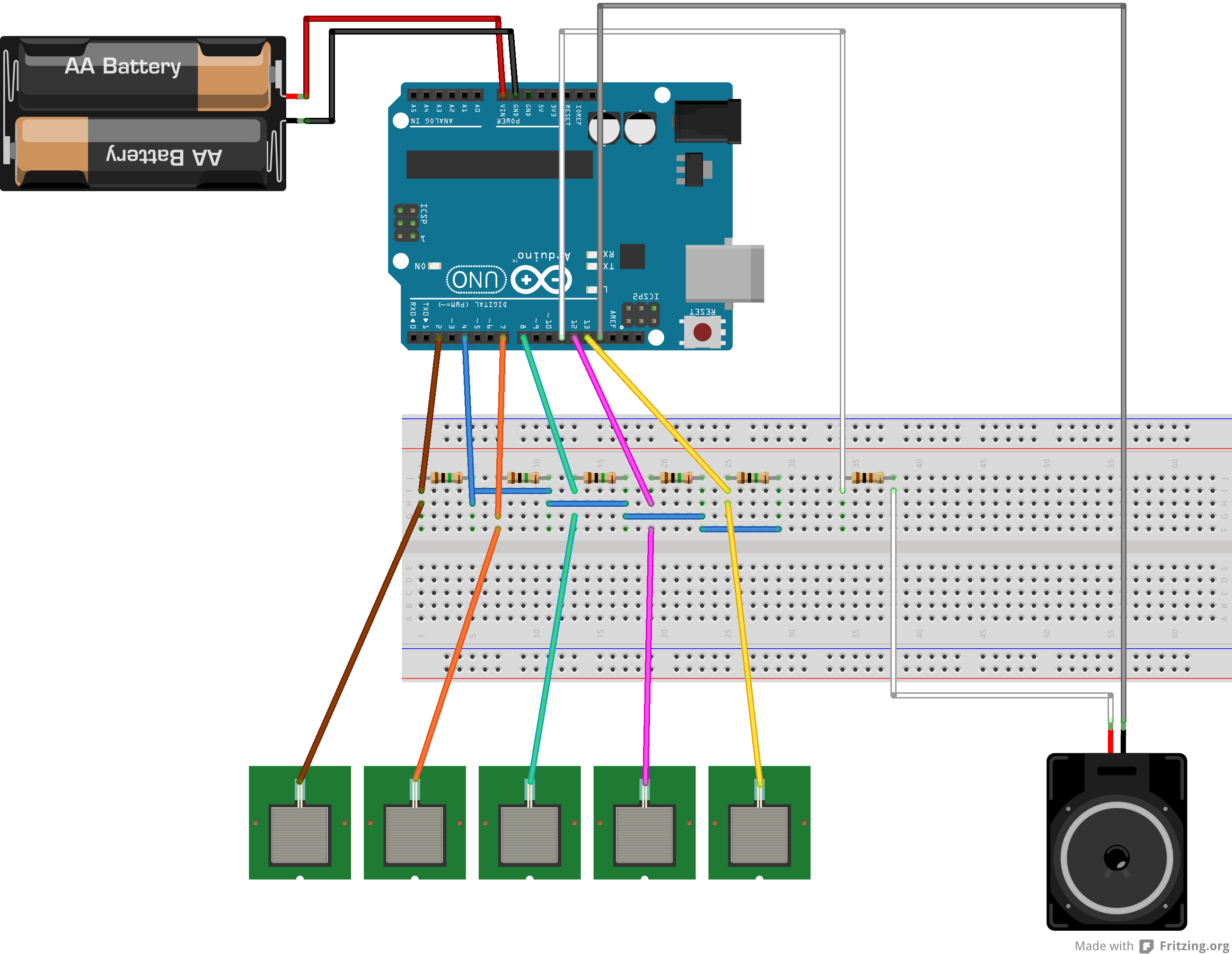

Hello,
My Arduino UNO it having a strange behaviour only when running the following code. I've made 5-Key Capacitive Sensor Key board with fluctuating sound, it's quite simple but at one point it seems as if it went crazy and starts playing without touching the keys. Indeed is really sensitive, because I have to be aware that anything istouching the shield or the key, even my woooden table. I have seen some proyects in which they have something like an "autocalibrate" or so. Could be that the problem? I copy the code and upload the fritzing image.

Thanks in advance,
Pulpalomita
      while (((total2 = cs_4_2.capacitiveSensor(30)) > 680) && (frecuencia2 < NOTE_B4))
What was the purpose of reading the sensors at the start of loop if you don't use those values?
What is the purpose of saving the value in a variable at all?
      noTone;
What do you think this is doing?
Gammon Forum : Electronics : Microprocessors : Arduino programming traps, tips and style guide <-- See Trap #9.
