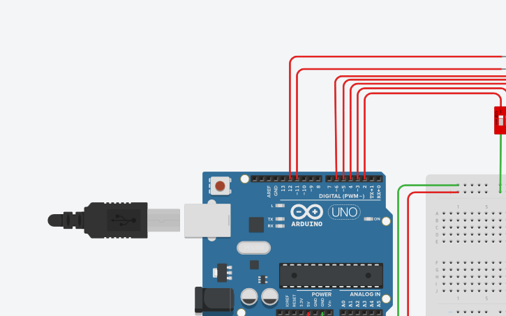

sorry, it is a bit paraphrased, it was over 9000 characters and could not post. i am researching the not delcared in the scope and once sorted, i can re run it and try again.
Robin2:
And you need to provide a drawing showing how the dip switch is wired to your Arduino.
schematic I sketched up in tinkercad
led on the end is just to see if it powered on .. thats it

Hii,
OPs test circuit;
You are using the DIP switches to pull the inputs HIGH.
You need 10K resistors on each of the inputs to gnd so the inputs will go low when the DIP switch is open.
Tom... :slight_smile:

trying using only 2 switches, rest //coded out
if both pins 1 and 2 off, down position, low --- startokPin - expected
if either 1 or 2 pin goes high, startokPin turns off and reversePin turns on - not expected, should require both to be high before it turns on right.
I cant understand why the && is not working as intended or is my understanding && is not all or nothing?
tinkercad link
tinkercad virtual project which I feel confident its wired correctly
