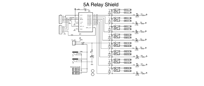

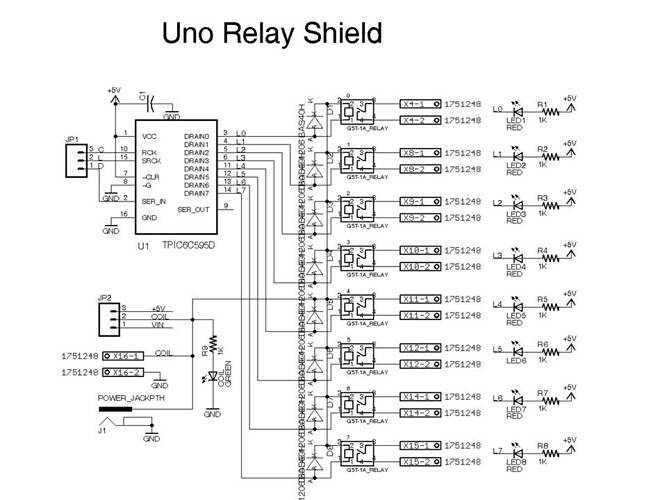

5A relay board
Got the right parts in to assemble an Uno Relay Shield.
Wired up Clock, Data, Latch to SCK, MOSI, SS.
Powered up from 5V. All the relays turn on as intended, indicator lights turn on, looking good.
However, I can't turn them off!
Tried adding 10K pullups across the coil pins (on the bottom of the board) to ensure the open drain outputs were going high - once they go low, they are staying low tho, 0.25V.
What do I need to get a High out to turn the coil off?

DRC checked out?
Solder bridges?
All enables etc. on the 595 are at the proper levels.
Sck looks good all the time?
May have some microscopic copper pathways between pads and traces.
DRC - was good when I ordered the boards.
Solder bridge - can't envision where a solder bridge could be that have the relay start off, turn on, then stay on.
There's certainly none visible.
OE is low, MRCLR is high.
SCK - will have to fire up the scope next I guess.

Arduino 595
SS RCK
SCK SRCK
Edited last post
Figured it out after a little nap. Clock & Latch lines to the shift register are mis-labeled. Swapped two wire wrap wires & life is good again :slight_smile:
Went to post - and I see you discovered the same. Thanks :slight_smile:

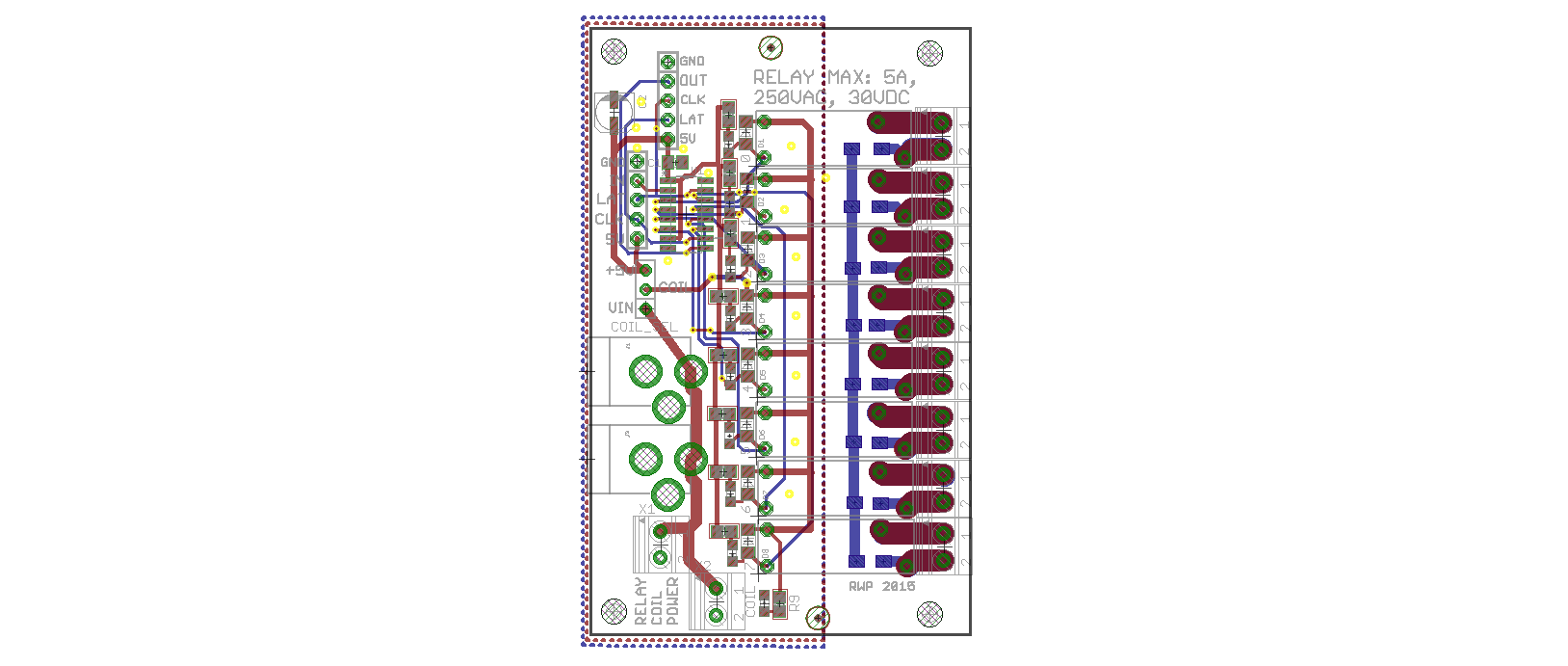

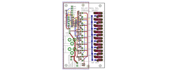

New version of 8-channel "shield" layed out.
Designed with easy daisy chaining in mind, both control and relay power with several options for hardware - barrel jack or 3.5mm screw terminals (or solder wires in the holes).
Couple of tweaks - added 10uF cap to shift register VCC pin to prevent any oddities if the coils are driven from the same 5V line as the shift register.
Added some pads on the back so the contacts could share a common connection, say for a return line in low voltage/low current use. Wouldn't recommend for AC use.
