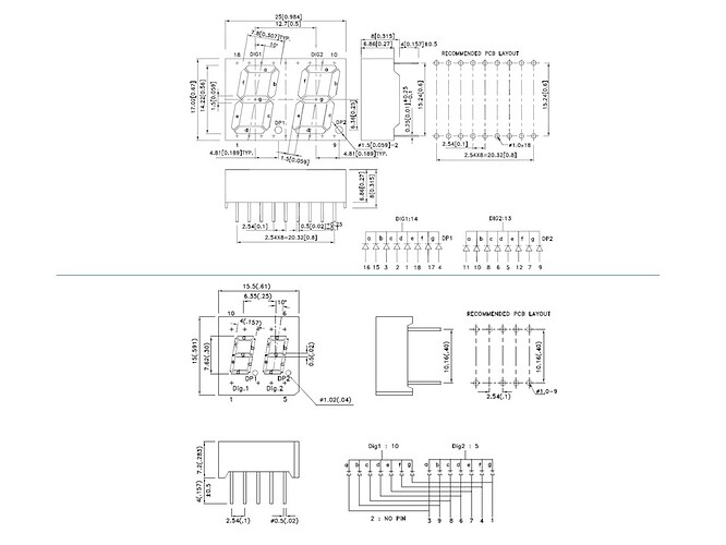

How many pins does your 7 segment display bring out ? About 17 or about 10 ?
Do you know if it is common anode or common cathode ?
Post a link to it if you are not sure.
Yes, is it like the top display here, or the bottom one?
And common cathode (as pictured) or common anode?
If the top one, you can connect the 2 shift registers to the 2 sets of segment pins, with a current limit resistor per pin, and connect the common cathode to Gnd, or the common anode to +5, and just your data into the shift registers:

If the bottom one, and you still want to use 2 shift registers, I would connect the outputs in parallel, thru a set of current limit resistors, to the segment pins.
Then shift in data as above.
However, you then need to time multiplex and one turn on one shift register at a time. You can do that by controlling the OE/ pin of the two shift registers. Turn on one for 3-5 ms, turn on the other for 3-5 ms, and keep repeating. The Blink without delay example code shows a good way to do that.

Forgot, common segment needs common cathode control as well.
Typically tho, for the common segment parts, most folks just use 1 shift register and the common cathode control, and shift out the data for 1, then the other, displaying either for 3-5ms.
I guess this is a school exercise, but for a normal solution, my preference would have been for using an atmega328p (or similar) with 2 transistors for the common parts (anodes or cathodes depending on the chosen display) and, if necessary, connecting the corresponding segments together so multiplexing would be required. The penalty is a less bright display.
I'm not sure about the design with 2 shift registers for the common segment version. I'd have to assure myself that there was no risk of 1 output pin being high and conflicting with a low output pin from the other shift register on the same segment. With high power shift registers ( e.g. TPIC6B595 which are purely low side) that is not, however, a problem.
"I'd have to assure myself that there was no risk of 1 output pin being high and conflicting with a low output pin from the other shift register on the same segment."
That's a coding issue. Could also use just 1 pin to one transistor and invert the signal going to the other - use one of the transistors for that even. Use the low from common cathode 1's collector to drive common cathode 2's base. Probably need a pullup resistor then to have some current available.
