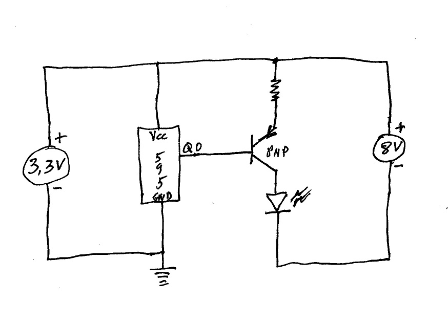

Further to my previous post, here's what it would look like:

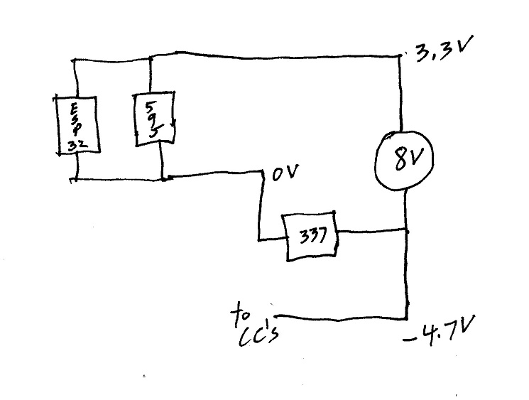

But I suspect you don't have a separate 3.3V supply. Need to know what it actually is.
As said, all this is easier with common anode because you can drive NPN transistors from almost anything, with the two supply grounds connected.

Then you should have also ordered 7 NPN transistors, the BC327s won't work with common anode

Instead of a step-down converter, you could use a negative voltage regulator like the LM337 to generate what will become a common ground for the ESP32 and HC595.
For the temporary 5V supply, perhaps you could power the HC595 at 5V. That would still let you drive the transistors, but the ESP32 at 3.3V might have trouble driving the 595. Actually, that would probably work, but just isn't guaranteed.
I'm not sure if there's a switching equivalent of the 337.
