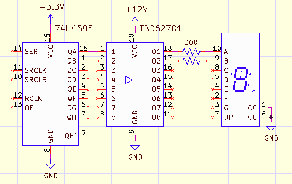

7-Segment SN74HC595N and BC327 Transistor

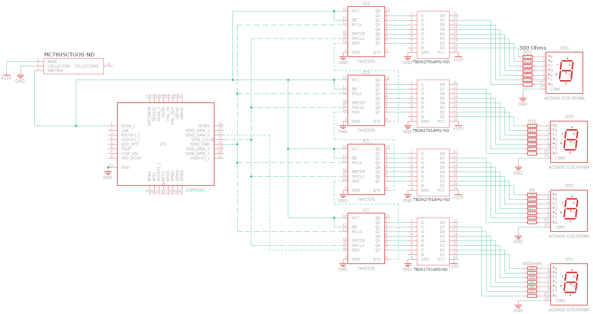

Is there some chip that i can use for power delivery? Currently using a 12v 1A power supply and then a step down converter for the LED power
You can use the 12V for the LEDs, you just need to use 300 ohm currenting limiting resistors.
Then for the ESP you just need as 12V to 5V buck for the ESP Vin input.
Dont i need 5V for the 74HC595 to work? And thanks for the image was about to draw one my self
The ESP has 3.3V I/O so you need to use 3.3V with the HC version
If you use a 74HCT595 then you can power it with 5V and use 3.3V signal levels.

Build a little Diagram of my plans.
All the Resistors are 300 ohms
Edit: Wrong display
I think you have the wrong part number for the displays. The ACSA56-51SURKWA is not large, has Vf of 1.95V, and is common anode.
Yes, I forgot to mention here that I still have to change that
I still have to create the correct display in fusion
Thanks for the help my clock works now.
