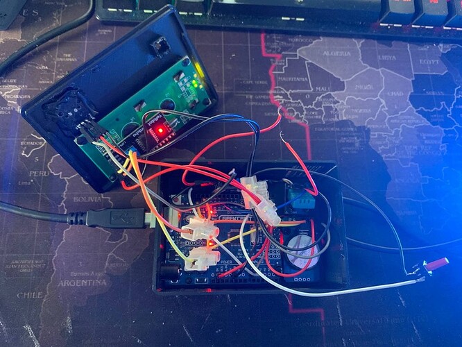

I found something interesting.
This morning I brought everything into the box and connected similar cables with terminal blocks.
Specifically I connected
RTC
LDR
LCD
BUTTON
Everything was perfect.
I therefore decided to link too
DHT11
SOIL SENSOR
as soon as I connected ARDUINO to the PC I heard the Windows sound of the disconnected devices.
From the IDE I could no longer select any COM port. Even after restarting the PC, still the same problem. I changed USB cable but nothing. I changed the door but nothing.
So I tried to power everything up and check all the connections with a DMM: everything is ok.
So I unplugged DHT11 and SOIL SENSOR and restarted the PC.
Now I can select the port and upload the sketch to Arduino, but it still doesn't work.

Can you please post some images of your project please?
What is powering your project?

The project is powered via USB.
I took a picture of the project in its current state, I couldn't do better because everything is fixed in the box.

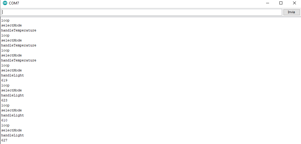

I tried to analyze the differences of the serial monitors (when it works and when it doesn't)
When the sketch works, the serial monitor prints
loop
selectMode
handleLight
"light value"
When it doesn't work, it just prints
loop
select mode
loop
select mode
It looks like it gets stuck in the "select mode" function, which in my opinion is a different function than "select Mode"

Sorry, but what you are reporting is not correct
You say
but what it actually prints, as can be seen from the screenshot (please don't post screenshots) is that it prints selectMode despite what you say
If you are printing teh function name at the start of each function then I would agree that it is just calling selectMode() from loop(), detecting no input then returning to loop()
The obvious conclusion is that either the code is not reading the button input or that the button itself or the wiring to it is faulty so that is the area to concentrate on.
  • Is the button wiring firmly connected ?
  • is the button connected correctly. You have to choose the correct terminals, not just any two
  • does the button work consistently or does it sometimes fail to close its contacts ?
  • check the voltage at pin 3 with the button pressed and not pressed. Are they what you expect ?
Have you checked that the button actually shorts the two wires together?
Usually you connect diagonally opposite connections on the switch to ensure you have the operating contacts.

The screenshot referred to the working sketch
As for the button, I checked several times with the DMM that the connected contacts were the correct ones. At pin 3 everything is regular.
Proof of this is the fact that I have now connected all the sensors and it works as it should.
I have never changed the contacts on the button
I have now hot glued the button contacts to prevent touching, however I checked with the DMM that the connections were correct
