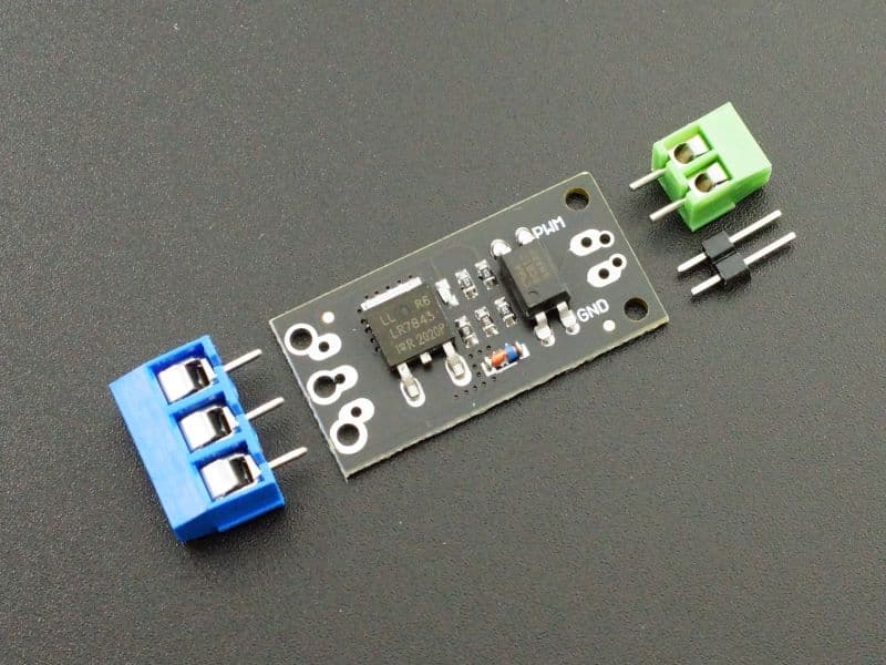

A stepper with a brake, controlled by Lr7843
The stepper is a MOT-AN-S-060-035-060-M-D-AAAD.
The brake has three wires : White: Brake 24V, Orange: 0V and Black: -.
The Lr7843has three outlets : +, Load and -.
How should they connect ?
Also , there is a LED on the MOSFET : it should only lit up when the brake is active, right ?
Cheers and thanks for all possible help, this is driving me nuts....
You also need to describe what you want to connect the stepper to!
If you have this:
wire like this:
Well, it's three wires from the brake unit (or "load" in that picture), and that complicates things.
And the stepper is already connected to a driver, no problems there.
Ok, finally got an answer from the maker of the braking unit: to totally disregard the black cable,
Isolate it and let it hang free...
