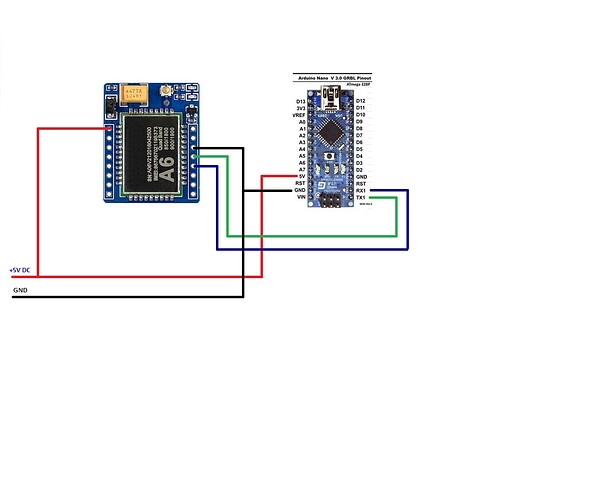

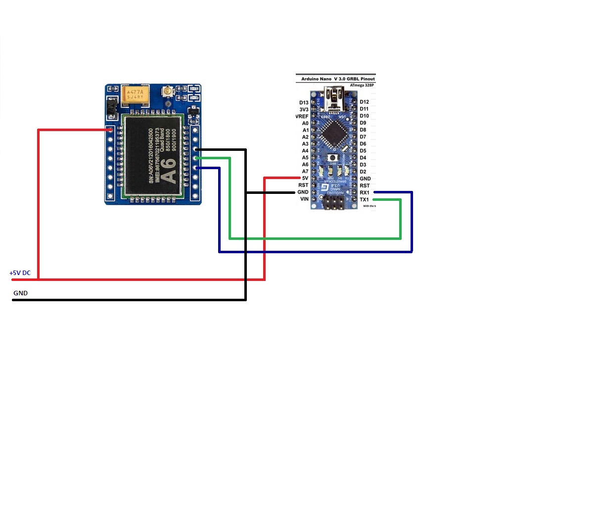

Hello,
first check my circuit for the nano-A6 min gsm module solution please. A6 mini module is working with +5V DC. Please also check and be ensure that rx-tx, urx-utx pins are in right connection.
After the power on, the A6 mini gsm module need few seconds to boot, and make connection with the mobile network. Normally after power on the red led is lighting, and after few seconds the blue led is blinking.
Try to use this code:
char incomingByte = “0000”;
void setup(){
void loop(){
Serial.println(“ATD032xxxxxxxxxx;+ENTER”);
delay(10000);
Serial.println(“ATH”);
