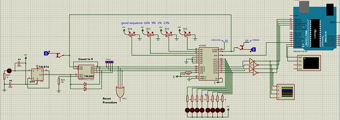

I made your connections.
Are your connections random on arduino pins? Or specific for some reason? If they are random, it might mean the connection will be resolved in code. Hmmm, must be it.
Now I have no idea how to make it work in arduino. Heh.
@b707 , do you know what to do from this point on?

Ok, now I realized, what that INT0 and INT1 means. (interrupt)
So those lines were to be put on pin2&3 of this arduino board.
I will make the correction in my sim.
Here it is corrected:

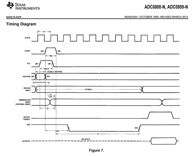

I got this from the TI datasheet
If I am not wrong the ADC cycle starts with a short LOW/HIGH/LOW on the START line.
End of conversion is signalised by a change of EOC from LOW to HIGH.
I tried to simulate the ADC behaviour in principle not in exact timing:

I dont understand your code.
I have 1 output and 1 input from Arduino to the ADC
const byte ledPin = 4; //for tests only
const byte interruptEOC = 3;//output for ADC0808, but input from Arduino
const byte interruptSTART = 2;//input for ADC0808, but output from Arduino
While in your sample code, you have 2 output and 2 input from Arduino to the (simulated) ADC. It is too confusing for me. Can you simplify your code to
1- fit my pin numbers (2&3)
2- fit my number of pins I'm using, 1 output and 1 input from Arduino to the ADC
Thanks.
I really tried your code and Im lost too soon to even start anything. I will try it some more if you cant help, but... its a bit too much.

Ive added that diode (and that wire link as it was originally). Im not completly sure how good it is... but for some reason it is...kind of working like this.
The most important fragment of code I concentrated was this:

Also I find this little detail in datasheet of the ADC0808:

Here is the cct setup:
Here is the code:

And here is the output on the Terminal:
Errors:
In the very begining, when is starting, is adding a double or weird number (sometimes), especially when is set to autorun in fast mode.
When you stop the automatic (fast) clock, is adding (sometimes) random or double readings.
But while in the process, everything runs OK.
So the start and the end are a bit of a problem. Probably is a simulator problem.
-----f-----
But if clocked Manually, everything is working Excellent !
