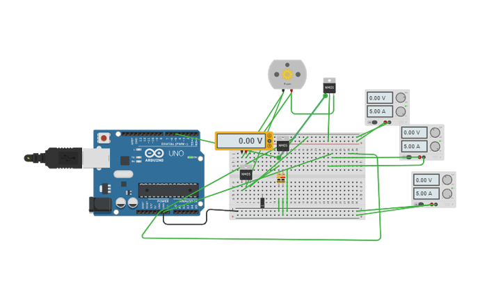

about mosfet transistor.
umm.. The questions came up while working..
First, look at this site that is simmilar with my project.
Just say power supply is 3A 3V and using pwm, upper one is 255 and the others are 0,
does red led take 3A3V or 1A 1V? In my project, it was 1A1V but I don't know why. Does the 0 mosefts are not blocking current? Is it flow to ground?
And I want to using both technology (like relay one and other).. Could you give me some help please :frowning:

oh... 3A3V was just an example.and LED also. My project is using motors.
My question is focused on pwm that all 0 or all 255(255 is all on state.)
If there is a 3 number of parallel circuit and 3 amperemeter, one mosfet is 255 and others are 0 state.
Then the state of ampere is my curious thing.
Not sure what you're asking, but with the LED strip it's three individual circuits.
They have nothing to do with each other, apart from a common 12volt supply.
Leo..
Can you post a wiring diagram along with that narrative? Very confusing.

ummm here is my picture though
just look amperemeter to motor
Sorry, that's completely unintelligible. Draw the circuit conventionally please, fitzing diagram with all green wires is impossible to read.
This is the example of circuit.
