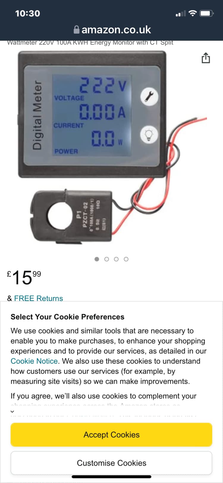

Clearly demonstrates you've not used a clamp-on current transformer... You don't connect anything, just clamp it round an existing insulated wire.
You are right. You pay more to get worse precision and some dubious safety?
Of course you often don't want (or dare) to break the wire to add the measuring resistor. But when you mess with the mains voltage for some other reason I see no benefit in the current transformer.
The other aspect not touched on here is adding a series resistance changes the circuits prospective fault current and may make the fuse disconnect time longer -possibly too long .
The truth is it’s a pointless dangerous method and a CT is a better solution that can give you a higher voltage output than the resistor and is cheap, and doesn’t involve breaking into the circuit .

Can the CT measure DC current (such in case the load users half wave rectifying)? What is its high frequency response? Can it measure i.e. switching power supply reliably?

A CT can measure such signals to an extent as they represent harmonics on top of the fundamental. You need to look at specs . Will your software be able to handle such signals ? Have you written any code yet ?
