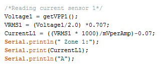

I'm currently doing a project on how to measure AC current using ACS712 and Arduino Mega 2560. The problem here is the result i got from my coding is not tally with the result I got from measuring the current using multimeter
What results did you get from your coding, and what results from the multimeter?
A much safer way to measure AC current is to use a current transformer, as described here: CT Sensors - Interfacing with an Arduino — OpenEnergyMonitor 0.0.1 documentation
You do understand what AC is, right? It goes positive & negative and it crosses-through zero twice per cycle. So... The minimum is zero and there's no need to "find" the minimum. The ACS712 puts-out a positive voltage but it's still zero twice per cycle.
If you simply read the values (like the Analog Read Serial Example) the values will look "random" because you are sampling a continuously-varying voltage.
You can take several readings in a "fast loop" over s short period of time and then find the maximum (ignoring everything else). Then, multiply by 0.707 to get the RMS. That 0.707 factor is only valid for sine waves (like the power line).
There is more than one version of the ACS712 and you'll have to look at the sensitivity spec (mV/A) to find the amps-to-volts conversion factor. And of course, you'll need to include the 5/1024 factor.
The result I get on my multimeter is around 0.29A but on the serial monitor it print 0.97. So, do i need to remove the line "minimum sensor value" from my coding? but the formula that I do look almost the same like what you just told me.
Ignore this nonsense.
For zero current, the ACS712 outputs Vcc/2, as described in the data sheet.
Please post ALL your code. What you posted will not compile and won't work.

Your approach is basically correct, but if the power line has noise spikes, the peak to peak measurement will be too high.
Why did you include the constant (-0.07) ?
Post a link to the exact module you have. Does it include a filter capacitor?
Are you sure you are using the correct mV/Amp scale factor?
Have you measured your Arduino power supply voltage?
Consider calibrating the sensor using several current standards, following this tutorial: Why Calibrate? | Calibrating Sensors | Adafruit Learning System
Hi, I'm using ACS712 current sensor 30A module. The data sheet of the module is as in the link below. I'm using 66mV/A for the conversion. I'm sorry for the (-0.07), I'm just trying to change the value on the monitor
Method is indeed correct, but the code could be more compact if you had used arrays.
Don't know why the original program is using such a long sampling time (1sec).
Long delays if you're measuring more than one ACS. I think 250ms (like a DMM) should be long enough.
What are you measuring.
Complex loads, like low energy lightbulbs (LED, spiral), could throw off the readings.
You must try these things with a resistive load (heater, incandescent lightbulb).
Remember that you only have a resolution of 1024/2*0.7= 358 steps across that 30Amp range.
The last digit of 0.97Amp is largely made up.

Thank you for the replies. I'm measuring incandescent lightbulb with power rating of 25W. Still can't figure out why I can't get the correct reading :cry:
My Arduino supply is 8 VDC.
The measured reading is around 0.08 A to 0.11 A. but i don't know why did it get to 0.97
I assume you're on 120volt AC (from the DMM result).
Did you first test ONE sensor, with the original code, before you tried to use three sensors.
Are you sure you got the 30A version of the ACS712 (should be printed on the chip).
Leo..

I'm measuring the current on 240V AC supply line and there is 30A printed on the chip just as you say.

SoftwareSerial mySerial (19,18); // which Arduino...
Is it a 5volt Arduino, and how are you powering the sensors.
A 0.29A DMM readout for a 240volt/25watt incadescent lightbulb doesn't make sense.
It should be 25/240= ~0.1Amp.
Are you sure it isn't a 75watt bulb.
Wrote this short test sketch that gets rid of the multi-stage way of calculating current.
And only a few lines are needed to calculate current for all three sensors when arrays are used.
If you need to calibrate, use the biggest resistive load you have (> 2000watt).
Post back the results.
Leo..
unsigned long startTime;
int rawValue, maxValue, minValue;
float current[3]; // for three sensors
float calFactor = 0.0259; // change last digit(s) to calibrate
  rawValues();
  // rest of the code here
  // current[0] holds the value for the first sensor
void rawValues() {
  for (int i = 0; i < 3; i++) {
    maxValue = 0;
    minValue = 1023;
    startTime = millis();
    while ((millis() - startTime) < 500) {
      rawValue = analogRead(i);
      if (rawValue > maxValue) maxValue = rawValue;
      if (rawValue < minValue) minValue = rawValue;
    current[i] = (maxValue - minValue) * calFactor;
    Serial.print("Sensor");
    Serial.print(i + 1);
    Serial.print(": ");
    Serial.print(current[i], 1);
    Serial.print(" Amp");
    if (i < 2) Serial.print("\t");
    else Serial.println("");
