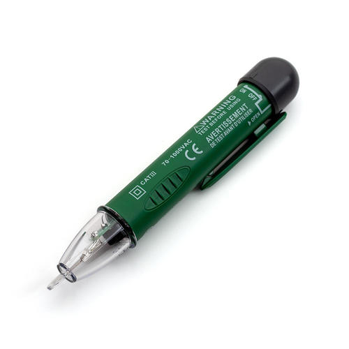

You need the circuitry that's in one of these:
Non contact voltage tester
I believe those things are basically an RC oscillator that stops oscillating when brought near a 50 or 60HZ voltage over 90VAC and switches an LED on.

https://www.princessauto.com/en/70-to-1000v-non-contact-ac-voltage-tester/product/PA0008436727
