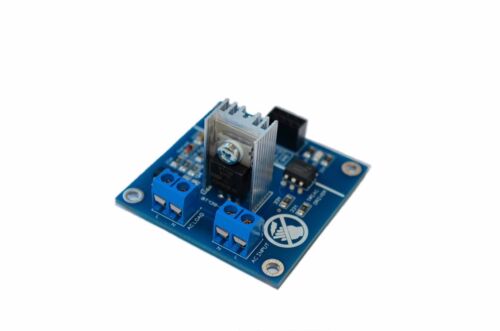

I want to buy a completed phase controller that I might control with an UNO for several voltage varying requirements. I have been unable to find a hobbyist version that is available for purchase. A pcb would be just fine. The only one I've found is on a group that makes pcbs but it is listed as untested. Please help if you know of some option that I might have available to me. My loads would be 120 volt at 1500 watts or less. I would appreciate any help.

1/ What do you want to drive? a motor? heater? lamps? -this determines the size of the components you need. You say 1500w at 120v, which implies a curent of ~13A, but some loads need a lot more than this to start them.
2/ There isn't a trivial way to do this. A triac with a trigger at a certain point in the ac phase is the standard way, but you need to determine the zero-crossing point of the ac source and trigger the triac after a delay. The above principle generates a 'chopped' sinewave - if you need a perfectly smooth sinewave of varying amplitude, this is much more difficult.
in any case the PWM is of no use to you.

There is this on Tindie
https://www.tindie.com/products/thewp122/ac-60hz50hz-dimmerssr-controller-board/

If you want to take a zero cross signal and use the wave chopping phase control method, there is this as well
With all these devices, you are going to have trouble getting 1500 watt output.

Thanks for all of these suggestions. I will study them. I found this on youtube today that seems to have promise.
I ordered this one from the company associated with the circuit. It was $25+ with postage. It does not use PWM but it does what I want. Thanks much.
