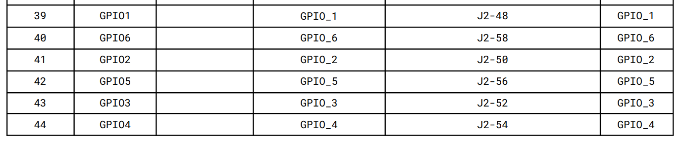

I refer to this documentation for the pinout table. I have tried multiple ways to access it based on the number like 50 for GPIO2, 52 for GPIO3 or using the GPIO_2 and GPIO_3 notation.
However, the GPIO_Number notation gives me an error when I compile the code and if i use only the number like 50 for GPIO2 pin the script always outputs 1 suggesting that the limit switch is not clicked even though I am clicking it continuously.
I am really trying to access the GPIO pins on the mid carrier in my script for an urgent project. Your help in this regard is highly appreciated.
Thanks in advance.

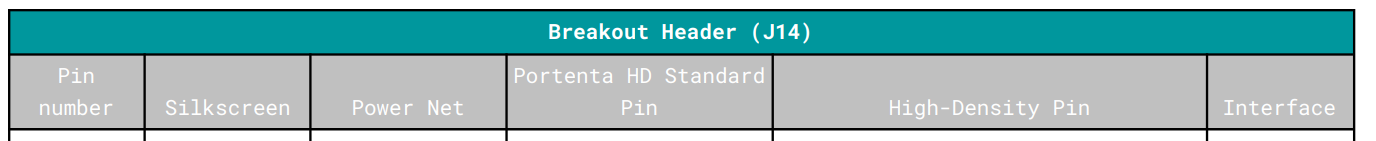

Hi @yishu17 don't have the Portenta kit (GIGA here) but looking at the docs
On J14, pin 39 = D1, pin 40 = D6 etc. Loose the GPIO_ and replace with D

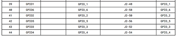

Hi @steve9 I tried that as well but that doesn't work either. I connected the limit switch output to GPIO1 on the mid carrier and updated the pin to be D1 on the code.
It works if i use the Portenta H7 board directly with the mid carrier which makes sense. But I want to make use of the mid carrier for my application.
hmm, that's surprising. Hopefully a carrier/H7 owner or Arduino Team will chime in to assist. If not, suggest raising a case with customer support.
A little more digging into the schematics for the HD interfaces, try:
PC_15 -> GPIO_1
PD_4  -> GPIO_2
PD_5  -> GPIO_3
PE_3  -> GPIO_4
PG_3  -> GPIO_5
PG_10 -> GPIO_6
As mentioned by others:
//#define limitSwitchPin GPIO_3
If you look at the Software Pin mapping file:
Portenta Mid Carrier SW Pinout Table
You see it is on pin PD_5 on the Portenta H7
And you should be able to use the PinName version of the pinMode
pinMode(PD_5, INPUT);
Note: If you need it as a pin number like: int limitSwitchPin = PD_5;
This will error...
So I found, that I could convert PD_5 to a number in the actual pin table by:
26 + (3 * 16) + 5 = 79
There are 16 pins per letter A=0...D=3 above...
I know that is crude, but worked for me, when I started on the HAT carrier.
