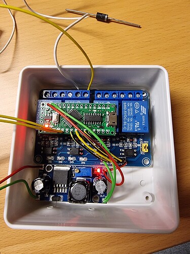

To make it simple I use a 4ch relay board and an Arduino nano.

Hi! I only had time to wire for a quick test at lunchtime today, so I won't have time to look closer at it before tomorrow. But so far it looked good. Think I'll have two questions, but will look at it properly first :grin:
@noiasca
It looks good, and at this moment I'm not sure there is any more than to play with it and the code to better understand the millis-function, since my goal with this was to learn how to perform sequences and repeats. I appreciate how someone replies directly to questions asked with knowledge.
When first testing it on an Uno, the delays was as expected. But when putting it on a Nano, the times did not correspond with milliseconds. I have no idea of why, I haven't used Nano much.
So far so good! :grin:
I don't know the issue with your Nano. The timings shouldn't be off.
Test with a short sketch. Print every 1000ms to the serial monitor. Does the Serial monitor respond at the defined speed every 1000ms?
