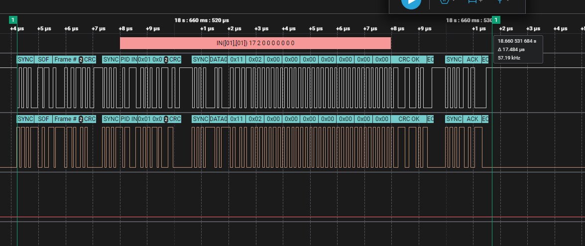

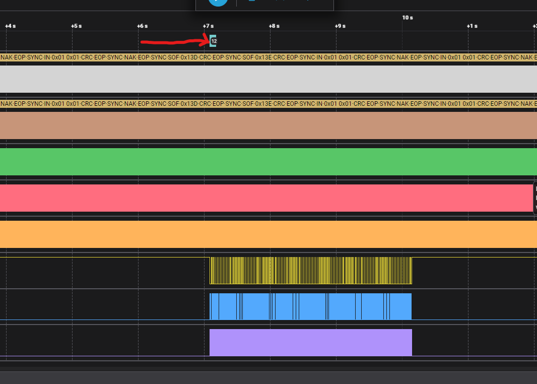

@Merlin513 and @BobTheDog - I was curious about the timing differences when the USB is in use and when it is not...
So hooked up Logic Analyzer probes to both USB pins, plus some of the SPI pins, did not do MISO nor DC pin as I wanted some extras to monitor when USB things are being called.
In this case I am using a sketch and device code I was porting over from our Wacom tablet library... This case is the tablet_viewer sketch.
Here is an area of trace when the screen is updated... Which happens if we receive new data from the tablet:
Top two lines are the USB.
The last three are the Display (CS, MOSI, SCK)
The Orange line (channel 3) is the time that an Endpoints call back is being called
Red(2) - is when the USB Task is active
Green(5) - is when the TransferComplete is being processed (Callback from ISR?)

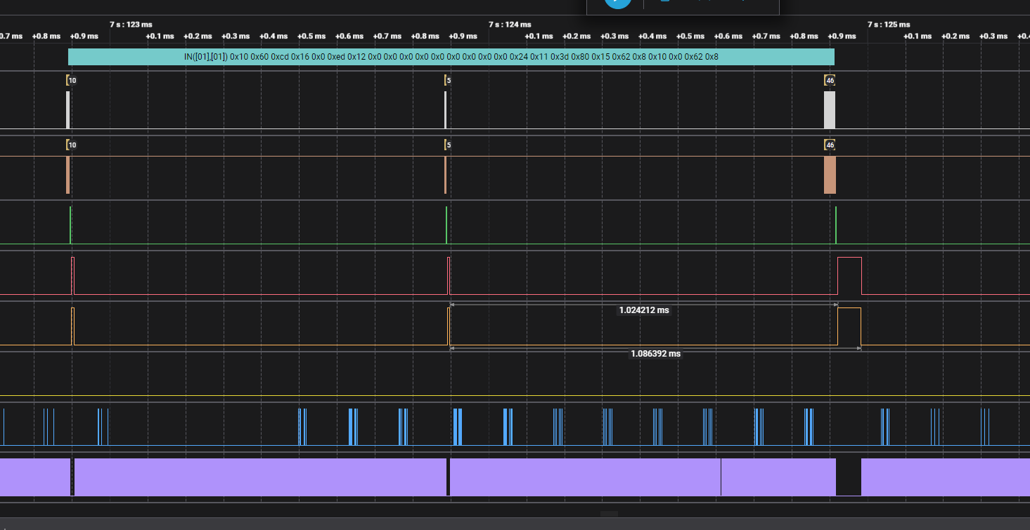

When we zoom out we see that all of our stuff is getting called a lot of the time even though the only time we are actually receiving new data is just in the area of the
area I sort of pointed to:
Also sort of interesting is when you zoom in on receiving one transfer in from the tablet
You can see it takes 3 transfer cycles or 2+ms to complete the transfer!
I would have hoped it was all completed within one cycle... Will try to capture something similar with the tabke us connected to something else.
It's called all the time (every ms) because it is an interrupt endpoint, so it is called every USB Frame.
Unless I am misunderstanding?
Sorry it is a Interrupt endpoint. But on the other systems I have worked on, the endpoint code is only called when it actually receives some data...
Maybe there is a timeout as well somewhere, but...

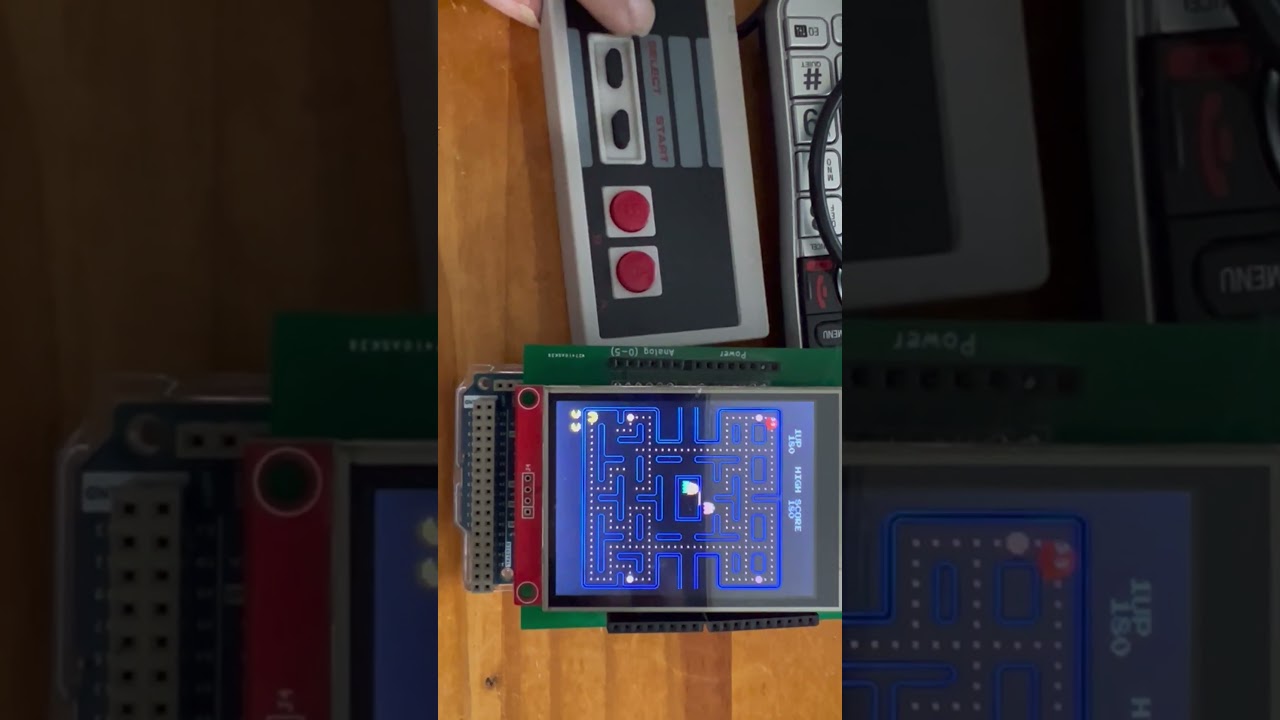

Using @KurtE's WIP branch PACMAN seems to working rather well now especially since I have added support for the USB version of a NES controller. Alot simpler controller. Want to verify tomorrow support I have included for the PS4 and PS3 and will probably post a short video on the topic
As promised here is a short video of it using the NES Controller

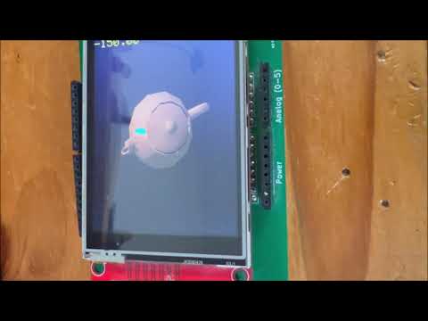

Since I am as much of gluten for punishment I wanted to see how the DMA transfers would perform. So I ported over my TeensyOpenGL library to Giga and ran one of test high res graphics sketches:
Doesnt work too bad. Now to figure out how to get the M7 process to go faster than 240Mhz :slight_smile:

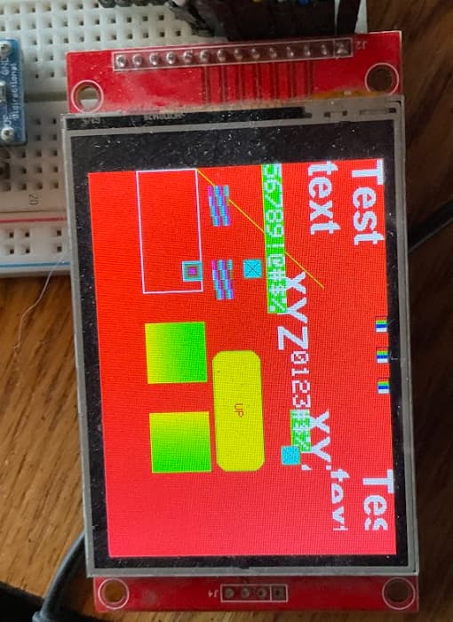

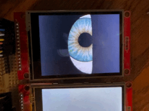

I have also implemented the continuous dma update mode and callbacks, which appears to work with my FB and Clip test sketch (example with library)
For the fun of it it, I made a version of the uncanny eyes we have running on a Teensy, with ST7735/ST7789 to work with ILI9341...
It is working with one eye, but two eyes I get the blinking red led crash...
Sorry for the poor-quality GIF file, I just did a quick live vew photo with my camera and then converted to GIF.
IMG_1813
Sort of fun :smiley:
Two Eyes
IMG_1814
I have not tried to do stuff in here yet to mirror one eye...
More a test to see if I can get two displays to work at the same time.
With my wiring and breadboard, I needed to slow the SPI down to 20mhz.
But looks like it is still outputting something like 20 frames per second.

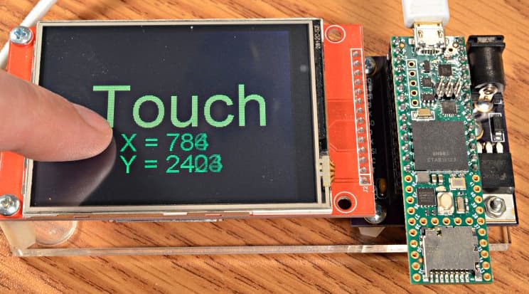

Note however, depending on which display you are using, there are issues if you do not connect the reset pin on the display.
That is if you are using a display from Adafruit, like:
3.2 TFT LCD with Touchscreen Breakout Board w/MicroSD Socket [ILI9341] : ID 1743 : Adafruit Industries, Unique & fun DIY electronics and kits
It should work if you don't hook up the rest pin:
However if you are using many of the others, for example like the ones sold by PJRC
PJRC Store
Or similar ones you can order from Amazon.com or Ebay.com... That look like:
Then you normally need to either wire the reset pin to an IO pin that you
pass into the library OR wire it to 3.3v as shown on the PJRC web page mentioned
just above.
Why, these displays do not wire up the reset pin to anything and leave it floating.
And if the pin reads as a low state, the display will be left in a reset state.
