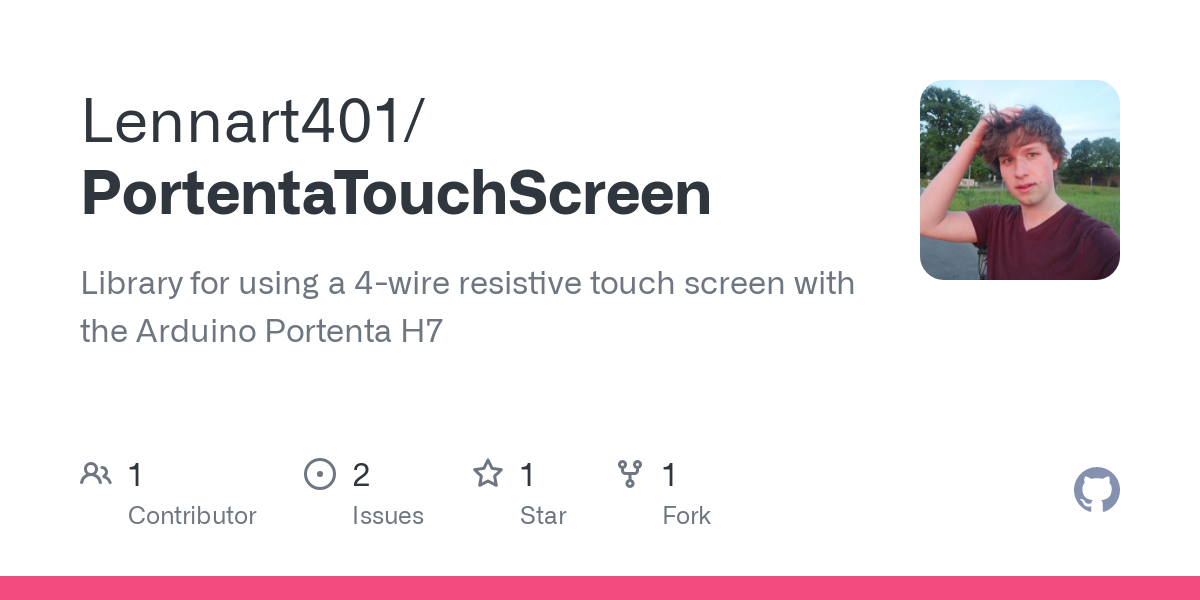

Anyone used the portenta yet with this library or have any examples? I tried the link below but did not have any luck. I do not have the touchscreen version.
This is what I'm trying to get to work.
// demonstrates drawing and touch operations.
// needs this library  Adafruit_ILI9341
// needs this library install as zip file https://github.com/Lennart401/PortentaTouchScreen
