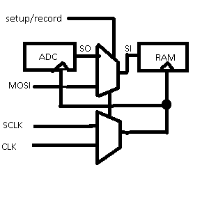

SPI RAM indeed should allow to take large samples at high speed. After the initialization sequence (write command and start address) the data can be clocked out of the ADC into the RAM, as fast as the ADC allows for. Slower is possible as well. Simple electronic is required to switch the RAM data input (SI) between the controller and the ADC SO.

Quoting myself:
DrDiettrich:
Once the start address is configured, the input can be switched to the ADC output, then both devices are enabled and the data is transferred at SCLK speed. The SCLK pulses can be forced by dummy SPI.transfer calls, or by any other clock source.
Like to draw a schematic?
Any multiplexer chip can be used.
DrDiettrich:
So put any multiplexer chip in the schematic.
Basically I can't see how this will work. One problem is that any command to the A/D will cause that command to be stored in the memory eventually, but there are other things I am struggling with. So a schematic would help me understand. If I am having a struggle to envisage this then I am sure the OP will not understand this configuration.
Other lines (CS, HOLD...) as required.
Been looking at this for a few days and I can't make it work in my head. It needs to be a lot more complex than this. You can't just use 2 input data select blocks.
What is the difference between SCLK and CLK?
