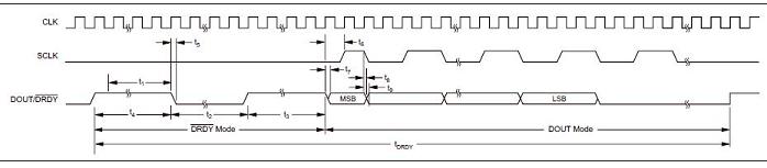

The ADS1252 has DRDY (converted data ready indication) and DOUT (actual data output) both on the same pin, one followed by the other in a chronologically structured way, so I can use proper timing and interrupts to check when data is ready and when to get data.
So my method is to initially have the microcontroller reset the ADC, so that we have awareness/control of the timing from then on (also see Timing diagram below)...
-At the start of a new conversion cycle, the DRDY phase lasts for 36 MCLKs (modulator cycle periods), so each cyle, we can wait/delay for the DRDY phase to simply pass.
-Then the DOUT phase starts and lasts for 348 MCLKs (typical numbers), during which we can clock out the data.
-At the end of each conversion cycle (36 + 348 = 384 MCLKs total), there is a low-to-high (RISING edge) in the transition from the end of DOUT to the beginning of DRDY, which we can detect using a RISING-edge interrupt/poll on the DRDY/DOUT line.
-And then the next conversion cycle begins, and so on.
Timing diagram (from TI datasheet)

MY INITIAL SEQUENCE
(1)
ACTION: reset by holding SCLK high for at least 4 conversion cycles
With 1 conversion cycle = 1 DRDY + 1 DOUT = 36 MCLK + 348 MCLK = 384 MCLK
RESULT: ADC is held into reset
(2)
ACTION: write SCLK LOW after holding it HIGH for 4 conversion cycles
RESULT: ADC is released from reset and begins operation
Then, for each of the conversion cycles, I do the following in a loop...
LOOP begins here
(1)
time_position: 0th MCLK; Beginning of conversion cycle, i.e., beginning of DRDY partition
ACTION: delay for an amount of time equivalent to 36 MCLK cycles
result: remaining time (36 MCLK cycles) of DRDY partition simply passes
(2)
time_position: 37th MCLK; End of DRDY; Beginning of DOUT partition
ACTION: read 24 bits of data
result: data read into microcontroller memory
(note: due to filter, data only starting from the 6th conversion cycle after reset is valid; see datasheet for details regarding the digital filter)
(3)
time_position: nth MCLK (post data-read-time); Somewhere in the middle of DOUT partition
ACTION: wait until interrupt triggered on DOUT/DRDY-line going from LOW to HIGH (i.e., RISING)
result: remaining time (post data-read-time) of DOUT partition simply passes
LOOP ends here
