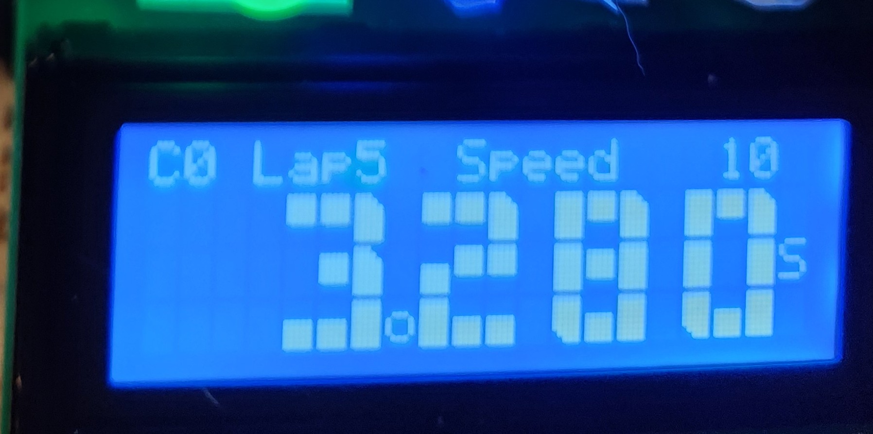

My trap speed detector is now working great, generates mph as expected.
In essence, I measure the number of ADC conversions per millisecond which is 36. If I have two lanes, then it's 18 per second. I count the conversions and send that down into the ring buffer for the main loop to do the floating point.

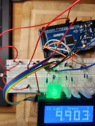

This shows the wiring. I will be swapping the 6 LEDs for 2 water clear RGB LEDs.
This way I have red, yellow, green flags and maybe purple :purple_circle: for pit call? Blue for winner?
Notice no light gantry is needed, I bought a floor lamp that shines much needed light above the table. With my two threshold measuring technique, no false positives from shadows.

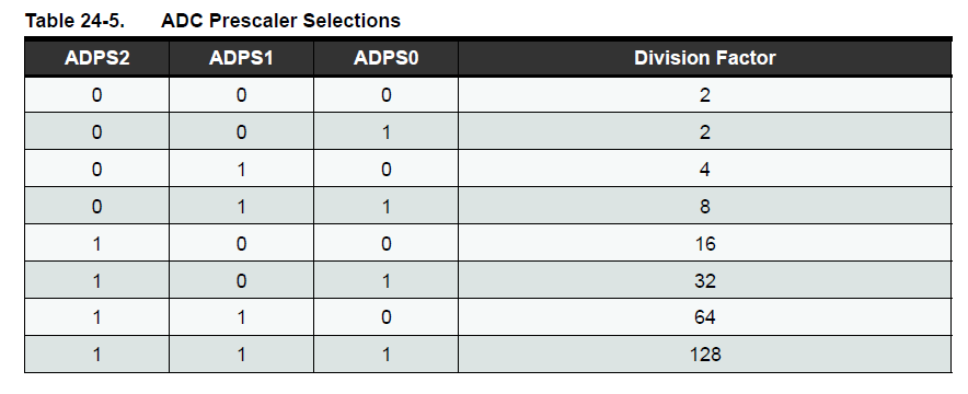

Your ADC will run at 1MHz, resulting in 76k measurements per second. This is too fast.
Normal in Arduino is Division Factor 128 to achieve a clock speed of 125kHz, resulting in 9600 measurements per second.
@stitech, it can read faster than 9600 per second but not as high as I am requesting.
Indeed, I need to calm that setting down as I'm currently getting 36 reads per millisecond, so 36000 per second. The while not ready loop, waits for the ADC to be ready. (This might actually be 38.5KHz giving the rounding)
ADCSRA |= (1 << ADPS2) | (1 << ADPS0);    // 32 prescaler for 38.5 KHz
So I think I should switch to the above or slower value to be more efficient than jamming up the interrupts.

76923 analog reads per second isn't happening now. My actual throughput is half that and the sketch is working very well noticing the car, so I should reduce the sampling rate.
This would be closer to reality:
This asks too much:
    ADCSRA |= (1 << ADPS2);                     // 16 prescaler for 76.9 KHz
This is perhaps the most important line of code, without it, everything goes to gibberish. This limits the rate to what it can actually do.

Interesting tidbit I discovered, halving the scaler cuts the samples per second in half. So if the interrupt was too slow, it wouldn't be linear like that.

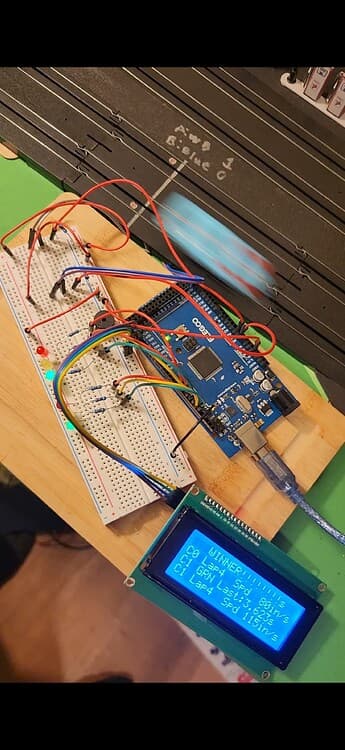

Hello, @jim-p asked for me to post my code.
Well here is my project page. Introducing Vroom Racer.
The project is playing testing well.
It has lane rider protection (when a car hops on your lane), automatic yellow flag, automatic red flag and even a competition yellow about halfway through the race.
I plan to post wiring diagrams as well.
