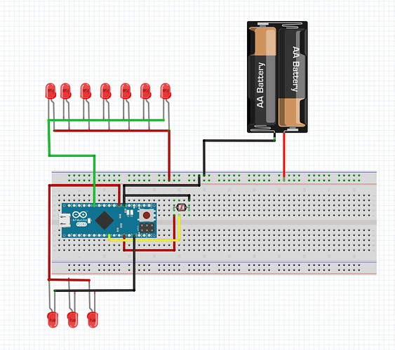

I am trying to add an Arduino Micro to a miniature kit that included 7 LEDs. The kit included a battery pack with 3x AA batteries to power the LEDs. Unfortunately, I have no information on the specs of the LEDs.
Id like to essentially turn the kit into a nightlight. Id be using a photo-resistor (LDR) to detect light amounts and if dark, the LEDs turn on.
I have attempted to connect the 7 LEDs in parallel to the Arduino while powered via USB, however the LEDs did not come on when a loss of light was detected.
This led to much troubleshooting.
I confirmed everything (Code, Physical wiring, correct pins etc..) worked with another kit I have that includes only 3 LEDs.
To confirm the LEDs worked and in the chance the Arduino was not able to power the 7 LEDs, I powered them via 3x AA batteries directly. The LEDs come on at full brightness.
I then attempted to have the 7 LEDs powered via the 3x AA Batteries and the LDR powered by the Arduino/USB. I get the same result, LEDs do not power with a loss of light.
Serial monitor indicates the LDR is working as expected.
In the diagram attached, I have both the 3 LED Miniature house, and the 7 LED Miniature house drawn. Ultimately, this is what I would be going for. I have attempted to isolate each as described above to work out what is going wrong.
To reiterate the Arduino is connected via USB power to a PC. The 3xAA Batteries would be used only to power the 7 LEDs when light is low.

Use a transistor driver for the LEDs.
Simple LEDs require a series dropping resistor.
The photo resistor requires a series resistor, probably 10k.

If you are using parallel set of LEDs then they will be drawing more current than the controller output pins supply, you may even damage the controller output pin.
You need to add a switching BJT or MOSFET for the controller to send its signal to, the BJT or MOSFET will then switch the higher current needed to control your LED strips.
You'll need one resistor per LED.
The current through a LED will be (Vcc - Vf) / R; e.g. (5 - 2) / 330 = 9 mA.
As mentioned, the safe current on a pin (for your microcontroller) is 20 mA; so you can put two in parallel on one pin at maximum. So you can possibly split your LEDs in groups of 2.
Your next hurdle is the maximum current per port (that is a group of (up to) 8 pins; consult the datasheet of the 32U4 microcontroller and the schematic of the Arduino Micro); this maximum is 100 mA.
Lastly there is a maximum of 200 mA through the GND and Vcc lines of the microcontroller (not the board).
One solution is to use multiple pins on the Arduino (taking into account the above limits). The alternative is, as mentioned, use of a transistor or mosfet; one transistor / mosfet will do but if you ever have a need to control each LED individually you will need to use a transistor / mosfet per LED (and you still need a resistor per LED).

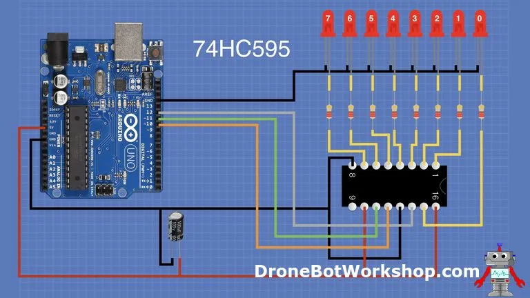

Try using a shift register... needs three signal pins, but I would use external 5V power.
https://dronebotworkshop.com/shift-registers/
