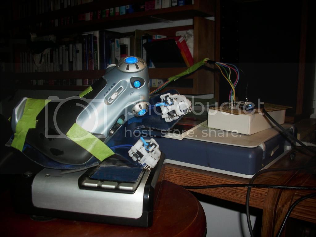

So I Need More Buttons on My Flight Control. A New HOTAS setup is beyond My financial means at this time.
So I hacked a few Switch Sets from these CR-V Door Latches We did as Recalls at Work(I'm a Master Tech in a Honda car dealership). I Purchased a Plastic-back Clipboard at Office Max to make Mounts for the Switches. I made a Template from Cardboard and Cut the Clipboard Backing. Then I used a Heat-Gun to Shape the Backing. The Wires all came from Hacked Honda Car Harnesses(from Wrecked Vehicle Repairs at Work).I Used the Wires that Connect to the Engine ECU.
While Its crude at this Point, I'll soon dress it up. I need to prove it can work in flight before I go & glue it on. I'll also put the wires into some Convoluted Tubing (also from Hacked Honda Car Harnesses).
The Micro Mounts on a 40-Pin I.C. Socket I Mounted it to a Perforated Board(Purchased from Radio Shack) by Pushing the Pins Thru the Holes and Bending them Over. I Hacked an Old SRS(Airbag) ECU(again from Wrecked Vehicle Repairs at Work) to get the Pins and Bent them Thru the Perf-board. I Soldered the Pins to the I.C. Socket Pins. This Makes a More Permanent Mount and gives Me the ability to change things around as I need it.
The Code was the Most Challenging(I'm not that much of a Programmer)...I Derived it from several examples, re-writing it several times before getting it to work.

I'd like to add Inputs from a Game-Pad Joystick thru the Analog Inputs, Turning it into a 4-way Hat Switch. I Hacked it out & I hooked it up and I can See it change voltage in the serial monitor; Just have to get the code right.
