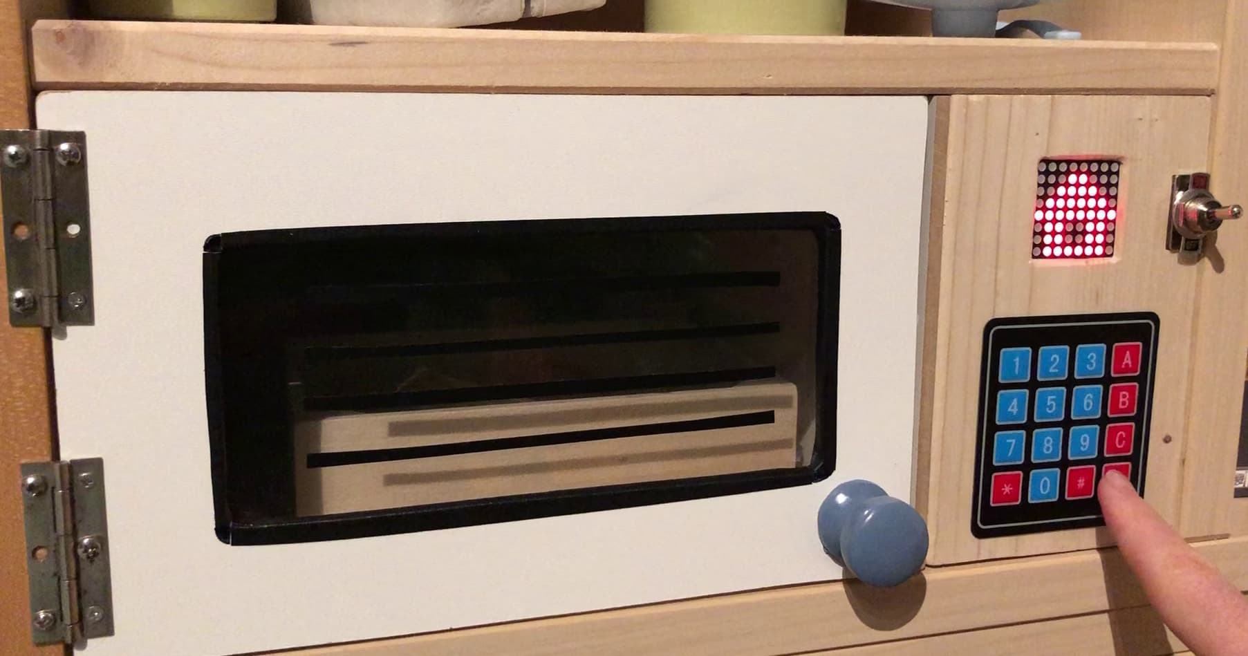

Hello,
I've built a DIY toy microwave for my daughter to play with (see picture below) and now I want to add two cooking plates that can be "heated" up and down via two potentiometers increasing/decreasing the brightness of two red LEDs. The code for both projects works fine when run alone, but once I insert the "cooking plate code" into the existing "microwave code", the microwave sounds generated by the passive buzzer are heavily contorted and also contain brief interruptions.
I don't think it's an issue of the wiring or of the parts I use, since this contortion happens even when I do not have any additional parts of the two cooking plates connected, but just add the code to the existing one. I guess it's an inherent problem of the tone() function, but I do not know an approach to tackle this.
Do you have any idea what's the issue here and how to solve it?
The microwave I built using:
  • Arduino Uno
  • 3x4 keypad matrix
  • one passive buzzer
  • 8x8 LED matrix (MAX7219)
  • one LED to light up the interior of the microwave
Obviously, the microwave doesn't really heat anything, but it "beeps" whenever my daughter presses a button on the keypad, shows this number on the LED matrix and does a countdown timer when she presses "*" on the keypad (i.e. imitates an engine sound and gives a final "Job's-done"-beep). Here's an image to give you an impression:
That's the (tiny bit of) code for one (!) cooking plate:

And that's the code altogether, which works like a charm as long as the Part ".../////Herdplatten und -Knöpfe" of the loop is commented out:

Your serial baud rate is unnecessarily low - the extra printing in the hotplate section may be causing your code to block.
analogRead takes about 100uS - it might be having an effect on timing. You can read it asynchronously if it really is a problem.
Start by commenting out all lines in that block except one. Problem persist? Focus on that particular line, what it does, and how it could be done quicker/better. Problem went away? Comment out that line, and uncomment another line to see if the problem emerges.
If not one single line is responsible for the problem, then start by only putting in certain kinds of lines, such as the print/println lines.
That way you can troubleshoot your issue in a more focused way.
Btw, that is a very nice toy you made there :slight_smile:
It isn't large compared to the slow baud printing, but instead of floating point math contortions consider using integer math with the multiplies before the divides:
  writeValue = (255 * (1023 - readValue)) / 1023; //Calculate Write Value for LED: when read is high, write is low.
Or even converting the resolution of the input to the resolution of the output:
  writeValue = 255 - readValue/4; //Calculate Write Value for LED: when read is high, write is low.
