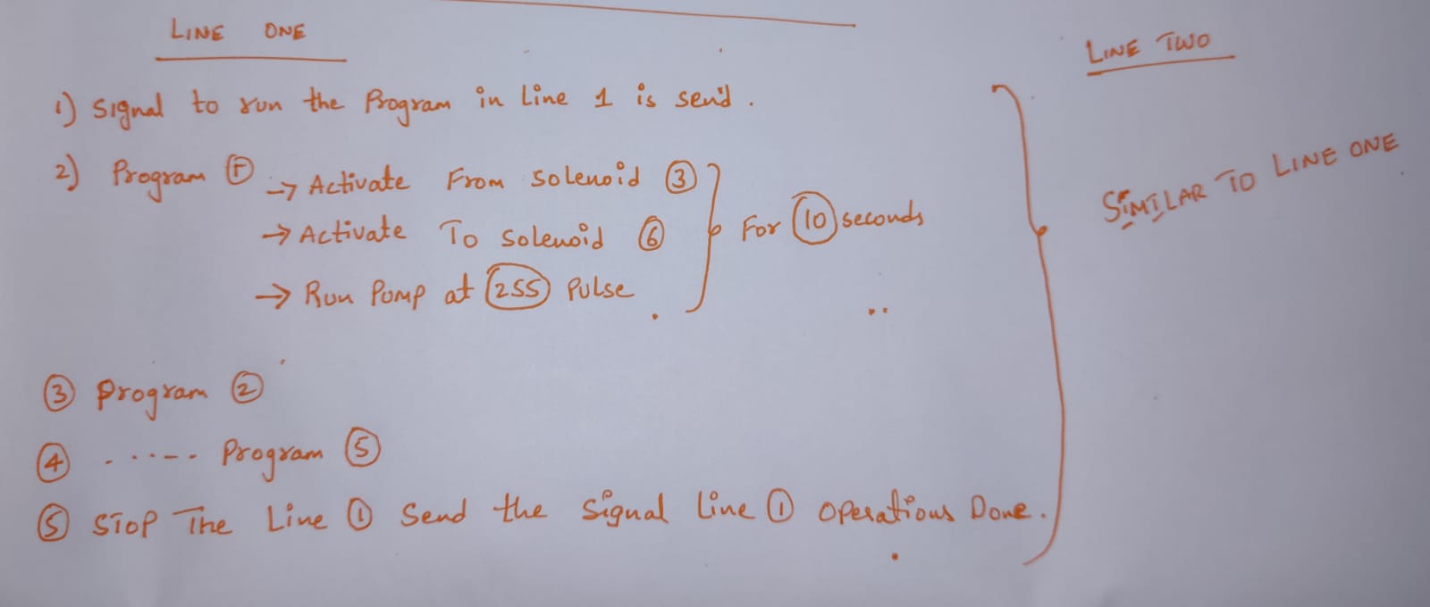

Thank you for the code "gcjr".I am sorry to be a little bit busy with my exams and haven't had a chance to try it out yet. It might take a few days before I'm able to test it out.
First things first, importanter things firster. I'm at the beach, so.
But I am sure we will be all over your latest efforts to 'splain what you are trying to do, so THX.

  1, 255, 3, 6, 10
  1, 100, 1, 2, 20
 1, 10, 8, 1, 40
it appears that there will be 2 "lists"of "programs" (previously referred to as "lines") separate lists for each of the 2 pumps.
and presumably when the program for a pump completes, the next program is processed, as i suggested in my last post
it wasn't at all obvious that these "programs" are sent, need to be stored and not processes until a "start" signal is received
one question is it looks like the time period for each operation listed in the examples are greater than the previous. in the image, the time for program 1 is 10 sec, program 2 is 20 sec and the last program is 40 sec. are these times the duration that the pump is on for each program or could they be an absolute time since the start signal that the pump is turned off at?
without separating the values in "program" strings, the first values of 1 and 2 identify the pump and which set the program is appended to.
what is the string for the start signal? ("3")?
what is the string for the done signal for each pump? (e.g "1 done")?
The OP has mentioned buttons that would initiate program lists that had been (fully?) received and stored. One per pump line.
The program list of 4 or 5 items comes to an end, that pump line is then idle.
But…
If the pump line start button is pressed while a program list is in progress?
If the pump line start button is pressed after that pump line has become idle?
If one pump line start button is pressed whilst the other is running?
If new program lists start coming in during a pump line run?
Is there a way to pause, interrupt or restart a program list?
I think the answers are all like we won't do that or that can't happen or similar ways of making questions moot at the expense of a fool proof system.
Guess we'll find out.

            char *buf = dequeue (& p->q);
            if (NULL != buf)
                pumpRun (buf);
        else {
            sprintf (s, "%s: pump %d active", __func__, n);
            Serial.println (s);
void
loop (void)
    msec = millis ();
    pumpMonitor ();
#if 0
    if (Serial.available ())  {
        int n = Serial.readBytesUntil ('\n', buf, sizeof(buf)-1);
        buf [n] = '\0';
        pumpReq (buf);
#else
    if (getProgram (buf, sizeof(buf)-1))  {
        unsigned idx = atoi (buf);
        if (3 == idx)
            pumpStart ();
            queue (buf, & pumps [idx].q, pumps [idx].label);
#endif
void
setup (void)
    Serial.begin (9600);
    Serial.println ("ready");
pumpRun ????
don't understand
a characteristic of good programmers is being able to clearly articulate what they are trying to do and what they are doing, both to themselves and others.
