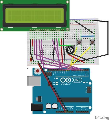

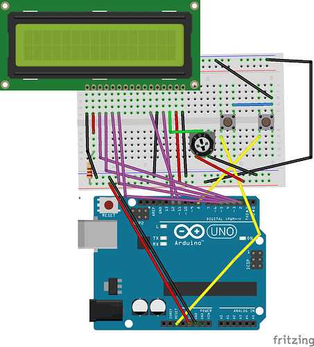

Here is the wiring i have:

Ok. Is this correct?
How do I create a function?
The way you have connected both buttons is good.
What is not good is that black wire on right side of the breadboard. That is connected directly from 5V to ground and will cause a short circuit which could damage the arduino. I think you made a mistake there!
EDIT: actually it won't cause a short circuit. But both buttons will connect to 5V instead of ground, so they will never read LOW.
