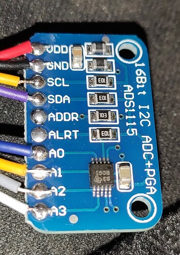

I'm using an "ADS1115" from aliexpress with a "Pro Micro" from aliexpress to measure the same signal at the same time. Pro Micro input is A0 ADS1115 is AIN1.
SPS = 860
Single input (Non diferential).
20k potentiometer from VDD (Regulated pro micro output) to GND.
I have also multiplied ProMicro output by 35 for comparisson purposses (5bit resolution difference = 32 so it's reasonable).
Code is simple enouth.

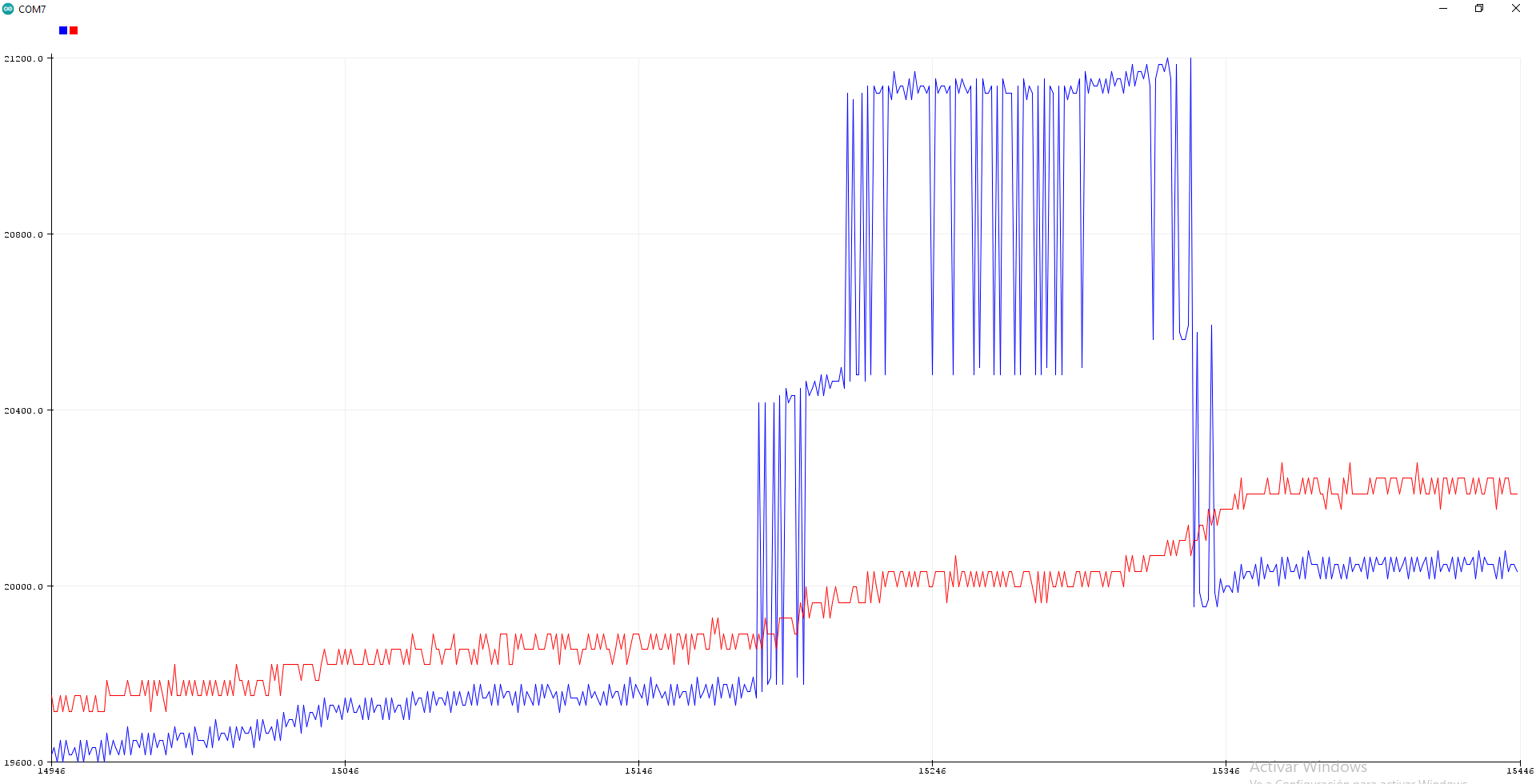

The problem is that "ADS1115" module output has "spikes" always in same outputs values.
All ADS inputs have same behavior, different gain settings gives same result, lower SPS reduces behavior... but it is an 860SPS capable chip...

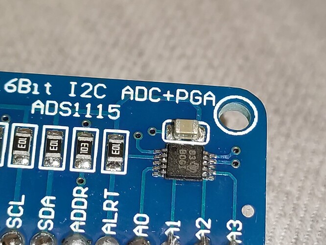

So. Do all ADS1115 behave the same or it's a defective unit or it is a bad chinesse copy? PCB looks good, same distributon, same components, as adafruit one.
IC has "83 BOGI" naming.

Pot is between VDD and GND.
ADS1115 is measuring pot. cursor against GND - Blue graph
Arduino is measuring pot. cursor against GND - Red graph
Same VDD and GND for both, Arduino is reading the ADS I2C data.
There is no signal lower than GND or higher than VDD.
Both are the same signal. I've represented both together to actually see their behavior.
Spikes are present at diferent thresholds (always the same thresholds), for example in the picture it is around 20000 (raw ADS1115 ADC output).

I reckon you've bought a counterfeit/fake/pulled chip.
Aliexpress definitely isn't the place I'd go to for any semiconductors.
You do pay more for that ADC from Adafruit or other reliable distributor, but it will actually work as advertised.
If not, you can get support from their engineers, send it back for a replacement, etc.
