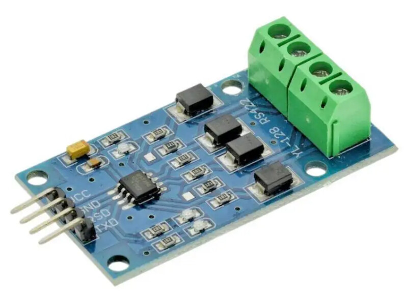

The input is from a commercial multiplexer with an RS422 output, and the output would ordinarily be the same. I may have to insert some signal conditioning circuits, but hope to get away without. The requirement comes from most wind instruments now using MVW. New Raymarine displays recognise it. However the design of the Raymarine tiller pilot is old and uses VWR that is supposedly obsolete. Required to maintain a course relative to apparent wind.
You do need an RS422 adaptor to connect to the serial pins of an Arduino because RS422 uses "differential signaling" with two pairs of wires (one for transmit and one for receive) and operates at possibly higher voltage levels (typically ±5V to ±12V), while the Arduino's serial pins use single-ended UART communication at lower TTL voltage levels (usually 0 to 5V or 0 to 3.3V). The adaptor converts these different voltage levels and signal types to ensure proper communication between devices.
Such ready made modules exists and are not expensive - something like that
https://www.aliexpress.us/item/3256807046108858.html
Thanks. I have built RS422 converter circuits before costing a few pence if I need to. I am concentrating first on getting some working code. I have log files with data from the actual output from the multiplexer.

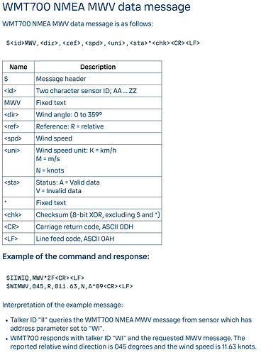

The fields need to be parsed using the , separators, as they are not consistent in presentation.
I can attach a typical log file of data and the spec for MWV sentences. This comes from the multiplexer USB serial output I believe, but it is a while since I took them off. They are far from clean data, many of the $WIMWV sentences, notable CRLF's missing. The data appears in the OpenCPN navigation application (via wifi from the mux) and appears there to have been cleaned up - invalid sentences no doubt dropped. Corruptions may be due to mux overload, but blacklisting is possible to a certain extent. I will have to look into this on site.
The RS422 output from the mux will drive the rx input to the Arduino.. have yet to detail that, and the output will drive some circuitry to create RS422 signals at 5v into the autopilot.
When I have confidence in the checksum code, I will use it to compare with the input, and drop any sentences that do not tally. (At the moment it appears to be generating a null string.) That logic is not there yet. I will also pass through other sentences as needed.
The code has trace/dump still within it, and as yet is work in progress, also attached
(attachments)
WMT700 NMEA MWV data message • WMT700 Series User Guide • Reader • Product documentation portal.pdf (186 KB)

Your log file would hold many frames, sentences, payloads … many names can be used ➜ it means a series of value, comma separated in your case as you mention, that forms a complete entry.
So yes share the log file.
See attachments above!
