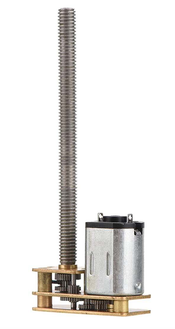

I am printing the whole structure and I would like to motorize the up/down of the platform with four DC 6V motors like these
I need the platform to always stay horizontal, I'm going to use an ADXL335 with an arduino to do this

what is the maximum rpm of these geared DC-motors with thread
what is the maximum speed how fast you can move the platform up-down with the given
gear-ratio from motor-shaft to the linear motion of the platform
how fast do you want to drive the crawler over ground ?
how big shall the slope be that the crawler shall be climbing up/down with one "driving-leg"
and for keeping the platform flat-level must be able to move the "driving-leg" up/down?

Raising and lowering objects is a typical use for a linear actuator. You will need a traveling nut on the lead screw.

The lead screw method with DC motor and no feed back would add to the complexity.

Even easier if you use stepper driven actuators instead of brushed DC motors. Since a properly designed stepper system doesn't skip steps, you know the extension of the actuator arm.

The output of the MPU6050 can easily translate (via a BRUSHED not BRUSHLESS Your motor in the pic is clearly a hobbly BRUSHED motor) to current to the correct motor to right the system. Of course you will eventually run out of "thread" on the bar if that is all it does so the opposing sides must run in reverse etc.
But it should be easy to do. No need for PID controller (IMHO) or the like. Since the adjustments are in real time the MPU6050 provides a constant feed back to the microcontroller and thus the current from the BRUSHED controller.
May I also suggest using a ready made linear actuator you can pick up cheep on eBay for each wheel assembly. In ebay search for "2"-18" Inch Stroke Linear Actuator 1500N/330lbs Pound Max Lift 12V Volt DC Motor" they start at 7 dollars!

That will simplify things. You might consider at least a once per revolution encoder to keep track of the vertical motion of each corner. You may want to include some limit switches to indicate when the platform is fully retracted.

I would think using opposites simultaneouly might be best? That might (might!) eliminate the issue: for example: machine is on a 10% grade to the right. Then the two right arms lower the right a bit as the two left arms raise a bit. Thus you never "run out of" thread or linear actuator length. The machine would always be "floating" around the mid point (length wise) of the actuator arms (or thread length from the photo OP posted).
I looked at his book list on line. None ring a bell. Crap... now this is going to drive me bonkers till I go through all my boxes of old books in the shed! LOL
If you use the lead screw pictured which has an M4 screw your motion will be pretty slow so you’ll have plenty of time to coordinate the motion of the 4 corners. You’re limiting the terrain to level ground will help to simplify the problem.
If you use a lead screw with a 30RPM motor your vertical travel will be on the order of 20mm per minute so I don’t see a need to control the motor speed. Two speeds, slow and stopped. :grinning:
