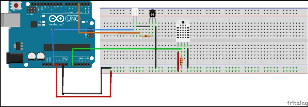

I assembled board + thermometer AM2320 + IR receiver VS1838B + IR emitter (D7 pin). I used 2 different sketches to read raw codes from RC of AC and took 2 different type of data.
In sketches number of pins may varys coz I did some experiments with different pins and mb uploaded here not last sctech with actual pin number.
I don't know C++ all code provided by vibe coding of gemini & qwen AIs
with this sketch
Main problem that board sends codes but AC doesn't react at all, but camera of smartphone shows that IR emitter lights shortly.

Use this demo code and post the output
Also post your IR emitter circuit.
Maybe the IR signal just isn't strong enough. Try placing the IR emitter very close to the AC unit's receiver.
If that works, and you want the sensor to be on the other side of the room, you need to boost the IR signal with a transistor circuit.
The ESP8266 pins can provide only around 12mA IIRC, so a series resistor of at least 150R would be needed, and the IR signal will be pretty weak. If you use a lower resistor, the pin could be damaged.

sry I don't got u about IR emitter circuit. from aliexpress, emitter is transparent

anode on D7 cathode on gnd

You need 120ohm resistor in series with your LED.
Be aware, the range is not high with this setup, but at least you can try it works.
If you need better range, you need transistor circuit to drive LED(s).

good news. 2n2222 took my project on next lvl, AC reacted to ON/OFF
and yes with IR emitter of this type u don't need 100ohm resistor on anode. It works as well as on this schematic even with Wemos D1 R1 ESP8266 and not original arduino.
While you might not need, some (even small value) resistor would give you some known current. Without you are likely abusing your LED, the transistor and arduino. Also, I would power it from 5V without passing through 3.3V regulator. And 2-3 LEDs in series would make it more efficient.
