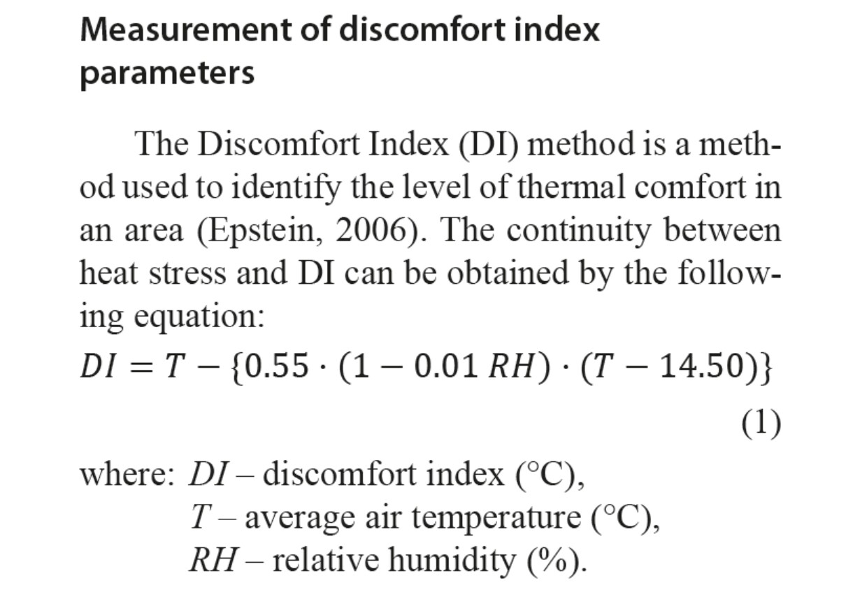

T = (DI - (0.55 * (1 − 0. 01𝑅𝐻) x 14.5)) / (1 − 0.01𝑅𝐻)

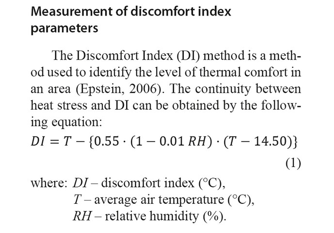

The formula is the algorithim. Just replace DI with 23 and RH with whatever you measure.
Temperature is givenin degrees Celsius..

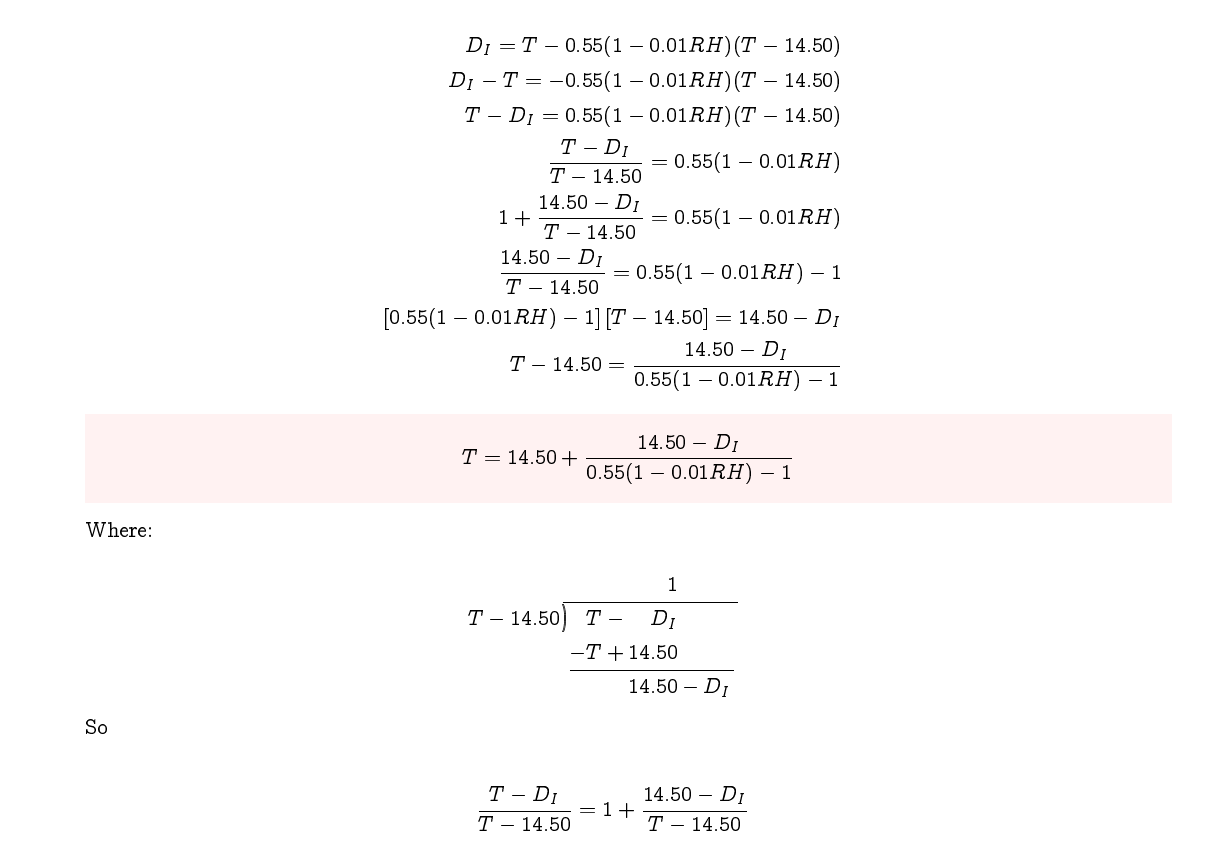

Just to clarify, the correct equation should be:
based on the original equation
imagen

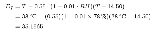

And assuming that:
Then:

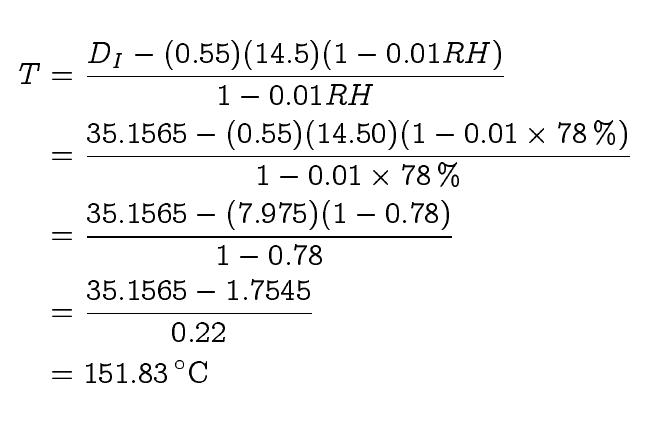

If we use the equation inside the red box to find the temperature assuming DI = 35.1565 and RH = 78% then:
On the other hand, based on your equation the temperature is:
Modern dehumidifiers work much better. Not theory, I have had two. One was in an area where we would get mould growing on the walls if we didn't have a dehumidifier.
You of course conveniently made a multiplication mistake when you used my formula.

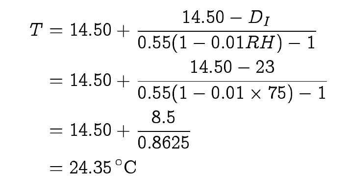

With
DI = 23
RH = 75%
Then
Your temperature should be 24.35 °C
