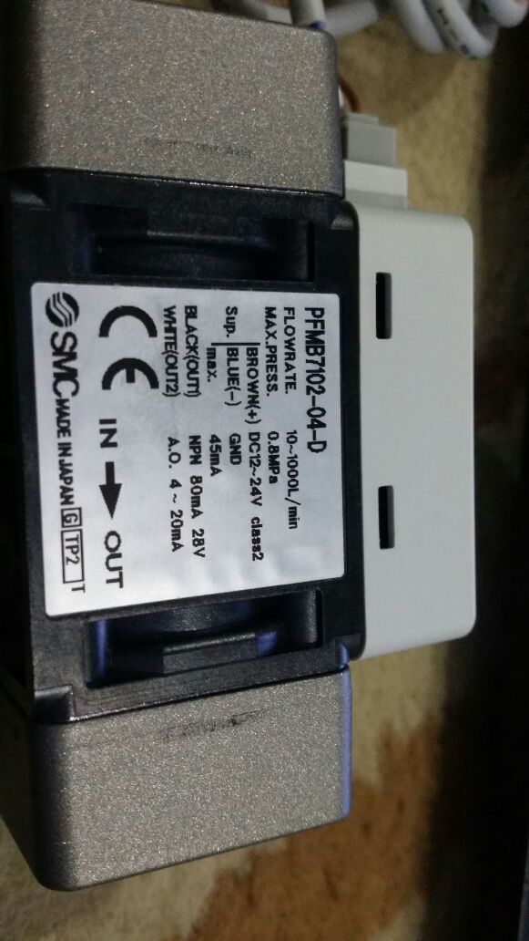

Hi Guys,
Need some advise on reading flow from SMC Pneumatic's airflow meter.
Output from sensor: 4mA-20mA.
Been trying to figure out how do get the flow from this sensor out to be read by my Arduino Uno. Does anyone have any idea? I need to use this flowmeter to measure the amount of air i consume daily... so i can get some info of how much of air i'm wasting at my tools at work...
Please help me out...
I've the picture of the flowmeter attached with this...
got this code from DIY hack...
Still not able to read anything from sensor....

the device outputs 4-20ma
i was thinking you would have an analog input for that ?
you have the input on pin 2 and have that as a byte.
assuming you have a resistor for the input, you loose 20% of the scale.
so using byte reduces overall resolution
I think you have the wrong program ?.
The program you have is for a flow meter that has pulse output, yours has analog output.
You just need to put a 250 Ohm resistor across the current output of the flowmeter, output 2 and negative.
And then connect the gnd of the arduino up to the negative terminal of the flowmeter output.
Connect the analog input of the arduino to the output 2 terminal of the flowmeter.
The resistor will convert the current into a voltage output of, 1 to 5V which is suitable for the arduino.
The software you have will not work, so you will need new software that can calculate the offset and scale the AtoD conversion to the units you require.
Tom.... :slight_smile:

You should be able to use the code you've provided if you use the NPN output (black wire) of the sensor. To the right is an interface I propose (untested):

http://www.smcworld.com/upfiles/manual/e/PF-OMP0002.pdf
look at your device,
then determine what part you have
then look at the output wiring available.
of course the proposed wiring will not work. you have an analog output device.
you will need to connect it to an analog input pin.
put power to the brown wire, 12DC
put a 500 ohm or some such 470, 520, etc from white to ground.
put white onto your Analog inptu pin.
tie the sensor ground to your arduino ground.
go to post #2, read, follow the link
go to post #1, highlight the text that is the program and then follow the instructions on item #7 and put your code in code tags.
you could just erase it as it does not apply to this device.

what threshold did you set the device to trip the switch ?
the black wire is the on/off alarm that signals either too much flow or too little flow. it should have tripped between full flow and no flow.
the white wire will be the one to use for analog. whole different wiring needed for that.
there was no reading from the Serial monitor output.
I changed your code (below) to use 115200 baud for the serial monitor because 38400 has problems with various versions of the Arduino IDE.
i found the circuit you suggested did not work.
The the interface should work, but its untested. It uses the digital output wire (black). The analog wire (white) is not needed.
Did you program OUT1 (black wire) for accumulated pulse output mode?
You can even change its polarity ... I believe either way should work.
See page 28+ in the manual.
