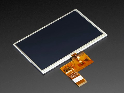

Maybe instead of stepper motors and analog guages, you could use a set of little displays like these
Or a larger display showing several instruments
I thought about using something like a cheap PC monitor and just displaying the instruments that way but I much prefer having analog gauges. I would be way simpler to use a smaller monitor but that doesn't pose a challenge for me.
Initially i was going to use monitors for everything but then decided that I want to spend more time and learn how things work and also I love making Arduino projects and I think this will be good practice.
Thank you for your suggestion. If I can't make good analog gauges I will have to use a monitor since I'm trying to build this for as cheap as possible.
