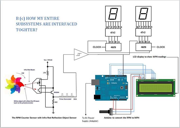

I am doing a project for my electronics Alevel. The aim is to develop a wind speed detector by using a Arduino UNO, Reflective Infra-red sensor and a LCD (see the attached JPG for interfacing diagram).
Current Logic:
The pulses coming from the Reflective Infra-red sensor increments a variable 'rpmcount' at every rising edge. Currently, I divide this by the number of wind blades. Below is my sketch so far.
Current Result:
For some unknown reason, it keeps reading RPM as 2.35mph even though I haven’t connected the output of the reflective sensor to arduino (bug?).

Are you saying that with nothing connected to pin 2, you are still getting interrupts?
Maybe enable the pullups and see what happens.

Yup, that was exactly what I meant. What do you mean by pull-ups? (I had no idea about internal pullup resistors on arduino. Idiot!)
I mean the built-in pullup resistors in the AVR processor.
What is the jumper wire connected to?
A jumper wire connected to Digital Input pin 2 on arduino (the other end not connected to anywhere.).

Have you got pull-ups or pull-downs on pin 2?
I have only recently started using arduino. can you briefly explain it? Thanks
If an input pin is not connected to anything, it is said to be floating.
This means that, if you read it, you can't be sure what it will return - maybe HIGH, maybe LOW.
If the pin is an interrupt, you may get spurious interrupts.
Connecting the pin to either the supply rail or the ground via a resistor means that if you disconnect the pin, you can be sure it will consistently read high (supply) or low (ground).
The AVR provides pullup (connected to supply) internally, or you can use external resistors for pullup or pulldown.
The internal pullups are enabled by performing a "digitalWrite (myPin, HIGH);" on a pin configured as an input.

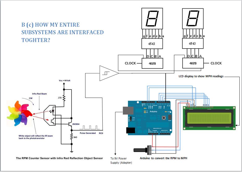

have u seen the picture that i have attached....i connected all the wires accordingly....can u plz refer with this

Can you give me a snippet of enabling the pull-ups or the pull-down on digital pin 2? (which you already have, kindof!). do I have to add this to the void setup ()
pinMode (2, INPUT);
digitalWrite (2, HIGH);
